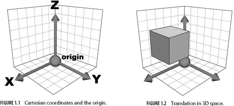

I don't think the question is saying that the wind is blowing upwards, rather it is blowing parallel to the pond and perpendicular to the x-axis. In otherwords, think about drawing an x and y-axis on the surface of the ice.

It depends how you orientate your axis; the standard way would be thus;
Two 3D coordinate diagrams side by side: left, Cartesian axes X, Y and Z meeting at a sphere labelled origin; right, the same axes with a cube translated above the origin.
Two 3D Cartesian coordinate diagrams: left shows the origin with Z vertical, X and Y axes on a grid, labelled 'origin'; right shows a cube translated in 3D space above the origin with the same axes.
Well, this is only advanced high school physics, so I'm pretty sure we're sticking with our regular coordinate system where y is vertical and x is horizantal. I know for a fact my teacher wouldn't assign a problem where our axes were different without letting us know.
This problem doesn't even call for 3-D space; just vector components in the x and y directions (our coordinate system being like I said).

So, if the y-axis is horizontal we can ignore gravity and the only force acting is the 17N wind force. So all you need to do is work out the acceleration and plug it into the appropriate kinematic equation to obtain the velocity in the y direction after three seconds.
