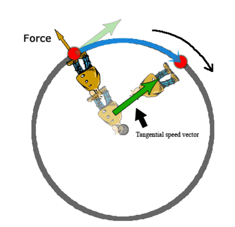

The other day, I was learning about creating "artificial" gravity by building a gigantic circularly shaped ship which would revolve at a frequency such that the centripetal acceleration coincided with the acceleration due to gravity [itex]g[/itex] (analogous to the shape and movement of earth).
I can definitely buy this: Surely it makes sense that the ship revolves similar to the Earth and thus gives rise to a centripetal acceleration toward the center of the ship which would be equal to [itex]g[/itex]. But then I saw a picture similar to the one below and immediately got confounded:
http://www.school-for-champions.com/science/images/gravity_artificial.gif
Since the revolution of that circular "ship" gives rise to the acceleration [itex]g[/itex] toward the center of the ship, wouldn't that person launch towards and "slam" into the center of the ship? According to me, it should look something like this:
Why? Well since the movement and shape of the ship is mimicing that of earth's, I figured the placement of the human beings ought to be similar. For comparison:
Is there something I am not seeing clearly?
The centripetal force is what holds him to the floor. What he is experiencing is centrifugal "force". If the floor wasn't there he would fly off on a tangent to the circle.
In the first picture, if the floor suddenly dissapeared, the man would float away in a straight line, as per Newton's First law of motion. This means that for him to move in a curved(circular) path, some force has to constantly push him towards the centre, and that force is the reaction force of the floor on his feet. It does the job of the centripetal force, and in the reference frame glued to the man, he'd perceive it as a centrifugal force mimicking gravity(that is, in the rotating space station, as on Earth, the floor is pushing us up)

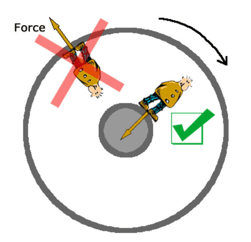

If you were to use the second picture, there would be no force to keep the man glued to the sphere. He would indeed float away with constant velocity equal to the tangential velocity he had at that instant.
The third picture does allow people to stand on the ground, because there exists a force, absent from the previous cases, i.e., gravity, which keeps the people glued to the floor.
Ok so what we essentially need to make sure of is that there is some "surface" which can disable the human beings from escaping the circular motion, hence positioning people according to the first picture?

No, he will continue traveling in a straight line, because of inertia, and this straight line will carry him back to the "floor".
Look at your first picture, the one where the guy is standing on the "floor" at about the 11:00 position. At the exact moment that picture shows, he is moving up and to the right because that's the direction that the but of "floor" he's standing on is moving. His jump lifts him off the "floor" but he's still moving up and to the right, so his path carries him back to the "floor" again. In fact, if you do the math (assuming that the force of the jump is small compared with the centrifugal force) he'll come down at the same place - the ring rotates at just the speed that makes that spot come around to where he lands.

Does he not have to move in a parabolic trajectory relative to the "floor" in order for him to land back on the same spot? Or were you meaning something like this:
He has the tangential speed represented by the green arrow, which is the same speed he has mid-air when he jumps straight up (the first transparent clone of him), and begins traveling in a straight-line fashion in the direction of the arrow.
In the meantime, the spot from which he jumped up (the red spot) keeps moving in the circular path and meets up with the him once he comes back in contact with the "floor" of the ship. I wonder why he ought to land with his legs perpendicular to the floor? After all he was traveling in a straight-line, what could possibly have rotated him and enabled him land perfectly on his feet, as if he had jumped straight up and landed back down again on a ground here on earth?

Assume for the sake of argument that he starts his jump at exactly the 12:00 position (there's nothing special about that position except that it's easy to write down his speed at that moment so the math is easier).
At that moment, before he jumps, his velocity vector is ##\widehat{v}=v_0\widehat{x}##, and after he jumps straight "up" with speed ##v_j## it is ##\widehat{v}=v_0\widehat{x}-v_j\widehat{y}## where ##v_0## is the speed of the rim of the space station and ##\widehat{x}## and ##\widehat{y}## are unit vectors in the positive x and y directions.
Therefore, if he jumps at time t=0, his position at time t will be:
[tex]x(t)=v_0{t}[/tex][tex]y(t)=R-v_j{t}[/tex]
where ##R## is the radius of the space station.
Now consider the trajectory of the red dot. It's going to be:
[tex]x_{dot}=sin(v_0{t})\approx{v_0{t}}[/tex][tex]y_{dot}=R-cos(v_0{t})\approx{R({1-(v_0{t})^3})}[/tex]
where the approximations come from the observation in post #11 that this entire artificial gravity thing only works when the speed and force of the jump is small. Because ##x_{dot}(t)=x(t)## we see that the jumper and the dot always have the same x coordinate - when the jumper meets the rim the dot will still be right under his feet.
Play with this some more, and you'll be able to show that the distance between the jumper and the rim describes the parabola that you'd expect.
