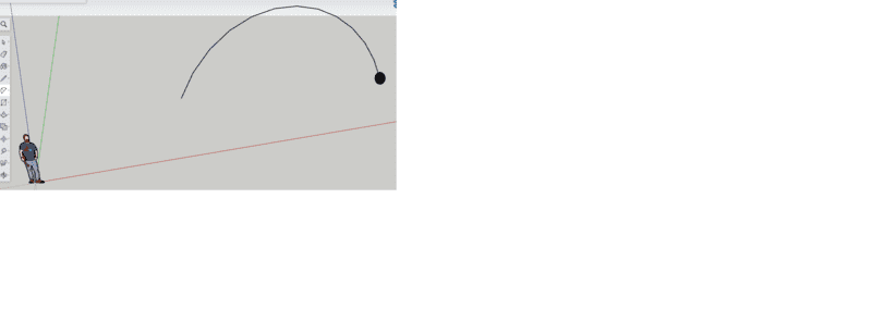

What is exactly the aspect angle in the 2 figures below?
Hi all, a bit confused with regards to the whole term aspect angle. Most examples that I searched online involved either a 2D plane or a stationary object.
In this case:
Let's say the man is facing the ball. In this case, the ball is being thrown from the right to the left. Since the man is looking at the ball (same axis), from his POV, the aspect angle will always be 180 degrees (since aspect angle is defined as the angle between the person looking and the motion of the ball)? Do I need to account for the height? Will that be the depression angle instead of aspect angle?

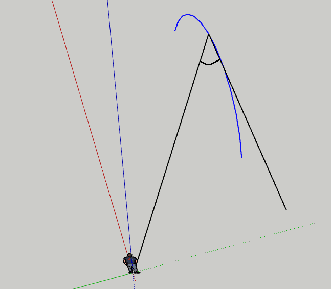

Second case:
Viewing from the top, let say another ball is thrown nearer to him as depicted. In this case, if the ball is somewhere in the middle of the motion, will that be the aspect angle that I have drawn out? Do I need to account for any depression/elevation angle?

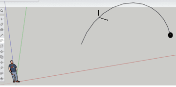

Assume the ball is going in the direction as indicated in the picture. From the man's POV, the ball will be directly heading towards him since they are in the same axis , just changing heights. Hence, I would have thought that aspect angle is 180 degrees.
As for orientation, do you mean which direction the ball is going?

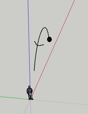

EDIT: This picture may give a clearer view.
Both man and ball lie on the red axis. Ball is flying towards the man in a projectile motion. Hence from man's POV, ball is coming towards him straight on. In this case, A.A is still 0 degrees? or 180 degrees? Does orientation matter in this context?

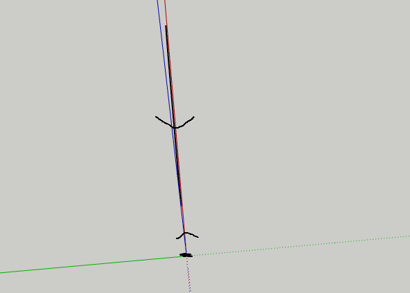

Top View:
Man facing towards the ball as shown, ball going up and coming downwards towards him as shown from the top view. Hence I would have thought a.a is 180 degrees throughout the whole projectile motion.
