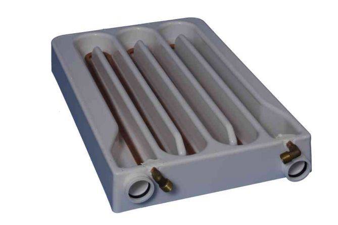

There is already many systems for this on the market.
"Greywater heat recovery system" is the water heat recovery you are talking about. And there is both systems that is just a box you put under a shower cabinet, and systems that you put in the drainpipes that demands more installation work. The nice thing about the box under the shower cabinet solution is that it is really cheap and does not demand any installation work (just connect the drain pipe to it, and reroute the cold water intake to the shower), and it is the biggest water heat waste source in the house. And it is easy to clean out because the drain water usually just run in a open gutter with the clean water going in a copper pipe in that gutter.
The simple version uses no heat pump so I'd assume it would only work to heat incoming cold water to a electric shower, perhaps. Or it could go in the cold feed to a thermostat which would then just 'top up' from the hot feed. The advertising blurb seems to imply that people use 50% of their hot water for showers. I would argue that the way to cut down on their bills would be to take

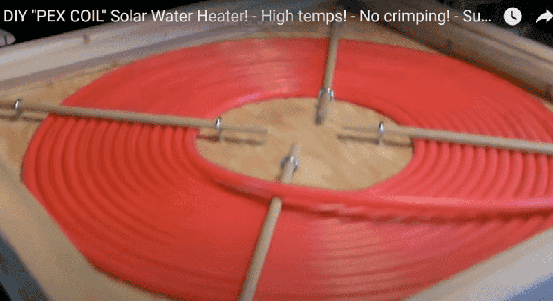

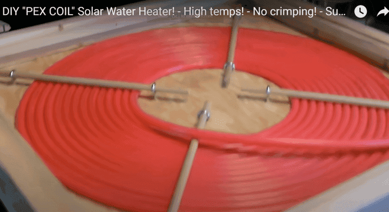

What a difference geography makes. Where I live (US-FL), some folks heat their water with waste heat from the air conditioner. Even my cold water is lukewarm by most standards. I recently had to size a water-water heat exchanger for a newly acquired water-jet cutter - the 'City' water is too warm to use without some pre-cooling.
Solar water heat is very common. In fact, it was very common 100+ years ago - until the ice company which was to become the dominant power utility started paying people to remove solar systems and install electric water heaters.
