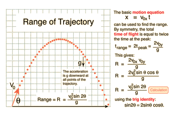

I used these equations. How do I solve the one I posted?

You can actually "solve" the equation. Use the formula sin(2Θ)=2sinΘ cosΘ.
One solution is of course Θ=0. Assuming Θ≠0 you can simplify sinΘ and reduce the equation to tanΘ=4.
Which is still a non algebraic equation but the solution can be found with a simple pocket calculator.

I would not have even used the equations of motion given, but deduced the answer from falling objects.
The projectile has to be aimed at a location P such that if an object is dropped from P and the projectile is fired at the same instance, they will both will fall for the same amount of time and also reach the ground at the same later instance.
At maximum height, h, the projectile will have traveled half the range, or a horizontal distance r. Knowing h = 2r, then P is at a height 4r. Thus simply by trigonometry, from the triangle with sides r and 4r, we can solve for the angle theta, and simply obtain, as you did, tanΘ=4r/r, or tanΘ=4.
Perhaps that is the "intuitive" answer being asked.
Similar to "where do you aim if one wants to hit a target, if the shot is fired at the same time the target is dropped", which is a usual textbook exercise problem.
