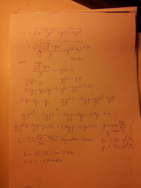

However, the part c is confusing me a little. I have tried setting v=0 and solving for h but I didn't get the right answer which is h=1.78meters according to my book. I know somebody will ask me to show the calculations so I ended up having equation of second degree like gρh2-5gρ+(4gρ-0.5p1+p2)=0 I got h>4m or h<0 which make no sense at all. Any piece of advice will be appreciated.

Here are my calculations for h when v2=0 I forgot to write the sub index 2. Am I missing something?

First assume that the 1.78 is right and calculate the velocity the same way you did it in the previous cases. See if that give you a velocity of zero.

There is a typo in my first post, the right answer according to my book is h=1.74m It gives me ≈0.6m/s≠0 So is my formula for v wrong in part c?

You don't really need to consider an equation for the velocity for this part. What will the pressure be at height 1m inside the tank when the flow stops?

According to my calculations, 1.74 m should satisfy your starting equation. So you must have an algebra or arithmetic error. (I told you to plug the answer into your starting equation and see if it satisfies it, but apparently, you had no value for doing that).

I did plug the answer(=1.74) into my equation of velocity and it didn't satisfy it. I will check my calculations.
I got:
[tex]\frac{(0.5)(4.2)}{4-h}+0.1(h-1)=1[/tex]
This is satisfied by h = 1.74
Chestermiller said:
I got:
Thank you Chestermiller! I got h1=1.7363m
