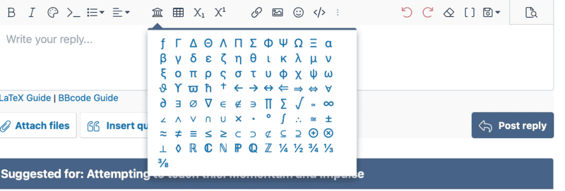

To @Windrose Academy : It took me a few seconds to decipher this as Δ(mv).
Windrose Academy said:
🔺️ mv
For future reference there is a menu with special characters that you might wish to use. See screenshot below
