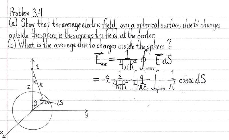

Griffiths' Electrodynamics, 4th Edition, Problem 3.4
Show that the average electric field over a spherical surface, due to charges outside the sphere, is the same as the field at the center.
$$\mathbf{E}_{\textup{average}}=\frac{1}{4\pi R^2}\oint_{\textup{sphere}}^{}\mathbf{E}\, dS$$
The picture above shows the integral that needs to be evaluated, and the associated picture ## \cos\alpha ## can be obtained via the law of cosines. I'm simply confused as to where the ##\cos\alpha ## comes from in the first place. I just don't see why ##\cos\alpha ## is necessary in this expression.
I don't recognise the character you have written as the square in the denominator of your integrand. I'll assume it is ##r##. That represents the distance from the little patch ##dS## on the sphere's surface to the charge ##q##.
Consider the electrical field in the little patch ##dS## due to ##q##. the strength of that field is proportional to ##\frac1{r^2}##. We can decompose that electrical field into two components, parallel and perpendicular to the ##z## axis, and we get those by multiplying the electric field by ##\cos\alpha## and ##\sin\alpha## respectively. We can ignore the perpendicular component because it exactly cancels out against the corresponding component for the patch we get by rotating our current patch by 180 degrees around the z axis - ie the patch with the same latitude and opposite longitude. Hence we are left with the parallel component, which is proportional to ##\frac{\cos\alpha}{r^2}##, as shown in the above integral.

So for a sanity check I decided to use the following approach. Since I don't know how to TeX the fancy r used in Griffiths' book, I'll use ##\eta##.
$$\mathbf{E}_{\textup{average}}=\frac{1}{4\pi R^2}\oint_{\textup{sphere}}^{}\mathbf{E}\, dS=\frac{1}{4\pi R^2}\oint_{\textup{sphere}}^{}\left ( \frac{q}{4\pi \epsilon _0\eta ^2} \right )\hat{\mathbf{r}}\, dS$$
$$\frac{1}{4\pi R^2}\frac{q}{4\pi \epsilon _0}\oint_{\textup{sphere}}^{}\frac{\sin\theta \cos\varphi \hat{\mathbf{x}}+\sin\theta \sin\varphi \hat{\mathbf{y}}+\cos\theta \hat{\mathbf{z}}}{\eta^2}dS$$
From the law of cosines, ##\eta ^2=R^2+z^2-2Rz\cos\theta ##. So
$$\frac{1}{4\pi R^2}\frac{q}{4\pi \epsilon _0}\int_{0}^{2\pi }\cos\varphi \, d\varphi \int_{0}^{\pi }\frac{\sin\theta }{R^2+z^2-2Rz\cos\theta }R^2\sin\theta\, d\theta \hat{\mathbf{x}}=\mathbf{0}$$

Essentially the problem is this integral and its result:
$$ \int_{0}^{\pi }\frac{\cos\theta }{R^2+z^2-2Rz\cos\theta }R^2\sin\theta\, d\theta=-\frac{(R^2+z^2)\log\left ( \frac{(R-z)^2}{(R+z)^2} \right )+4Rz}{4z^2}$$
The direction of the electric field as shown in post #3 is normal to the sphere but should not be so. The curly ##r## that Griffiths uses is the vector from the source to the point of observation. I dislike it because it leads to confusion as is the case here. I prefer to use the more conventional (and transparent) expression for the electric field due to a point charge ##q##, $$\mathbf{E}=\frac{kq~(\mathbf{r}-\mathbf{r'})}{|\mathbf{r}-\mathbf{r'}|^{3}}$$where ## \mathbf{r}## = the position of the point of interest and ##\mathbf{r'}## = the position of the source.
Here the source is a charge at distance ##z## on the ##z##-axis and the point of interest is on the sphere. Therefore,$$\begin{align} & \mathbf{r}=R\sin\theta\cos\phi~\mathbf{\hat x}+R\sin\theta\sin\phi~\mathbf{\hat y}+R\cos\theta~\mathbf{\hat z}\nonumber \\&
\mathbf{r'} = z~\mathbf{\hat z}.\nonumber \end{align}$$The component of interest that does not integrate to zero is$$E_z=\frac{kq(R\cos\theta-z)}{\left(R^2-2Rz\cos\theta+z^2\right)^{3/2}}.$$

I see now that my vector was defined incorrectly. Thanks a lot.
