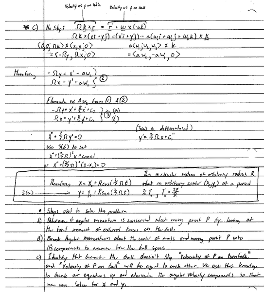

Can someone please help me out with this tough problem?
1. Homework Statement
A ball rolls on a turntable without slipping describe the balls motion in terms of (x,y) for a function of time. (The turntable spins at a constant rate)
(This all the information that the professor gave us.)
My professor said the answer has 7/5 in it somewhere. Can someones please help? I'm really confused about this problem.Here are some sources that helped me get my answer:

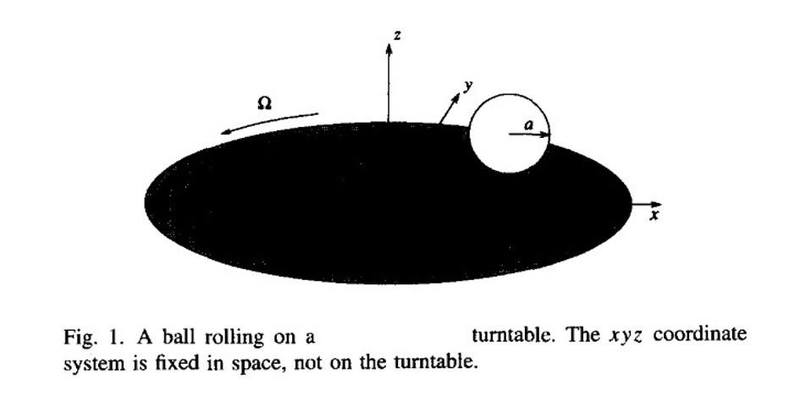

I'm not quite clear on what you are given.
It looks like a turntable of unspecified radius is rotating with angular speed ##\Omega##.
Choosing rectangular coords (z axis, pointing upwards, as the axis of rotation and the origin on the upper surface of the turntable) - so ##\vec r(t)## is the position of the point of contact at time ##t##, then: ##\vec r(0) = (r,0,0)^t## (chose x-axis to be through the initial position of the ball.) The ball is constrained to move in the x-y plane in contact with the surface ... it's initial velocity wrt the z axis is not given, but it is rotating with angular velocity ##\vec \omega## which depends on it's position (because it does not slip).
How are you thinking about the physics here? (I cannot, confidently, read your handwriting.)
ie. What stops the ball from just staying where it is, can't it just sit there and spin?
If the ball moves across the turntable - isn't it's angular momentum coupled to that of the turntable?
Z (k) points out perpendicular to the turntable, X (i) points out to the right, Y (j) points out 90 degree from x (coordinate system is fixed in space). The spherically symmetric ball of mass “m”, moment of inertia “I” about any axis through its center, and radius “a”, rolls without slipping and without dissipation on a horizontal turntable (so frictional forces act on the ball at its point of contact with the turntable, but do no work). The turntable is rotating about the vertical z-axis at constant angular velocity Ωzˆ. (radius of turntable is unspecified)I apologize for my poor hand writing. I'll tell you how I attempted to solve the problem.
In part A of my work I determined that angular momentum is conserved about the moving point P. (Point P being the point on the ball in contact with the turntable.) If I'm not mistaken that would mean that the angular momentum at moving point P is coupled to that of the turntable.
In part B I broke the angular momentum into its components to examine how the ball spins:(angular momentum at Center of Mass)=(moment of inertia of a ball)*(angular velocity) or
hcm=IW
ν= (2/5)ma^2*<wxi + wyj + wzk> (angular momentum at Point P)=(angular momentum at Center of Mass)+(Radius “a”) cross product (linear momentum)
hp= hcm+ a x p
= hcm + a x mv
= hcm + a x m<vxi + vyj>
= hcm + <-mavyi + mavxj>Therefore,
(2/5)ma^2*wx - mavy = C1 C=constant
(2/5)ma^2*wy + mavx = C2
Wz=C3In part C I acknowledged that because the ball doesn’t slip “The velocity of point P on the turntable” and the “velocity of point P on the ball” will be equal to each other. I used this knowledge to break up the equation and eliminate the angular velocity components so that we can solve for x and y positions
Ωk x r = v + w (cross product) (-ak) Ωk= constant rotation about the z axis
My final answer was:
x=xo + RCos((2/7)Ωt)
y=yo + RSin((2/7)Ωt)
My professor said this was wrong and he let me take a glace at his answer. His answer had 7/5 in it somewhere.
I’m still really confused about this problem and I’m not sure if I approached it the right way. I would really appreciate it if you could give me some insight on how to solve it

Suppose the ball is at point (r, θ) on the disc. Its centre has tangential velocity ##r\dot\theta## and radial velocity ##\dot r##.
Since it does not slip, what does that tell you about its rotation about the tangential and radial axes?
What is its angular momentum about its centre?
What, then, is its angular momentum about the point, fixed in the ground frame, which is instantaneously the point of contact?
If you convert that to Cartesian, then set that it is a constant vector you should get equations for SHM.

After Converting I got this answer.
my professor said this was wrong.

Converting will not immediately give the trajectory, of course. You have to use the constancy of ##\vec L_p##.
##r(2\Omega-7\dot\theta)r\cos(\theta)-7\dot r\sin(\theta)=c_x##
##7\dot r\cos(\theta)+(2\Omega-7\dot\theta)r\sin(\theta)=c_y##
Which gives me a circle with angular frequency ##\frac 27\Omega##, same as you get.

I still don't understand how my professor got ##\frac 7 5##. Do you think he could have made a mistake or is there maybe some alternative way of solving this problem?
You and I independently got 2/7, and rcgldr provides experimental confirmation.
