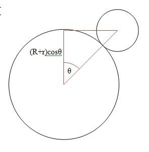

In yor perspective the potantial energy on "top" will be zero that's nonsense.The total potantial energy is ##mg(R+r)(1-cosθ)## or ##mg(R+r)(cosθ)##
There is a problem with the unlucky point on the attached graph. With big ball centre as origin the potential energy is ##mg(R+r)\cos{\theta}##.
If you consider left picture you need to realize the potantial energy is cannot be zero top but If you consider right picture you will consider that potantial energy iz zero.I am not wrong which one x and which one is x-axis and which one is y-axis ? I assumed left picture and If you assumed same thing then my equation is true.But If yıu assume right pic your equation is true.

On the OP, the potential energy variation makes the move, indepented from origin. See a better image.

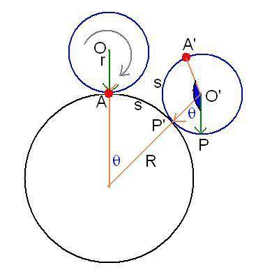

See figure.
The contact point with the sphere is the red dot on the ball. The ball rolls a distance s on the ball , so the point A moves into A', and the length of arc P1A' on the sphere is s. The angle <P'O'A' = s/r, but the ball turned by the angle <P'O'P more. The angle of turn of the ball is Φ=s/r+θ. s=θR, so Φ=(R/r+1)θ. ω=dΦ/dt and ##V_{CM}=(R+r)\dot \theta##.
I understand but can't imagine. the ball rotates only a distance s, so how can it rotate more?

I meant "if it rolls a distance s" along the surface of the big sphere. It can roll shorter or longer .
Draw a big circle of radius R and cut out from paper a small one with radius r=R/3, for example. Roll the small circle along the circumference of the big one and see at what angle it turns while it rolls along an arc of length equal to its own circumference, 2πr.

The angle the ball rotates is Φ.
$$\phi=\frac{s}{r}+\theta=\frac{R\theta}{r}+\theta=\left( \frac{R}{r}+1 \right)\rightarrow \omega=\dot\theta\left( \frac{R}{r}+1 \right)$$
