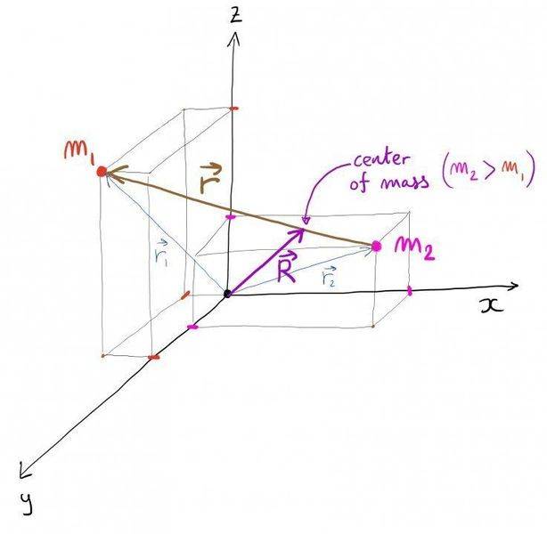

So first I drew the "situation" (see attached picture) and forgot everything about a barbell. :biggrin: I assumed ##m_2## was bigger than ##m_1## to have an idea of what's going on, but that' not so important. I called ##\vec{R}## the vector going from the origin to the center of mass and ##\vec{r}## the vector going from ##m_2## to ##m_1##. ##\vec{r_1}## and ##\vec{r_2}## are the vectors going from the origin to respectively ##m_1## and ##m_2##.
a)
So first I wrote ##\vec{R}## and ##\vec{r}## in terms of ##\vec{r_1}## and ##\vec{r_2}## :
##\vec{R} = \frac{\vec{r_1} \cdot m_1 + \vec{r_2} \cdot m_2}{m_1 + m_2}##
##\vec{r} = \vec{r_1} - \vec{r_2}##
I define the reduced mass as ##m := \frac{m_1 \cdot m_2}{m_1 + m_2}## and I rewrite those to get new expressions for ##\vec{r_1}## and ##\vec{r_2}##:
##\vec{r_1} = \frac{m}{m_1} \vec{r} + \vec{R}##
##\vec{r_2} = \frac{m}{m_2} \vec{r} + \vec{R}##

  • Hand-drawn 3D diagram with x, y and z axes from the origin, showing masses m1 and m2 joined by a brown vector r, with position vectors r1 and r2 from the origin, the center of mass R marked with a magenta arrow, and the note (m2 > m1).

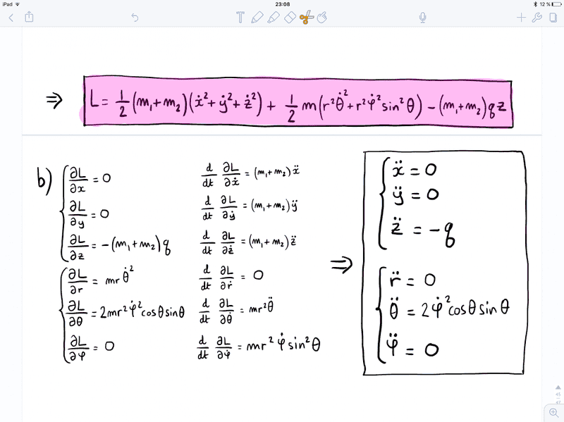

##\ddot{z} = -g##
and
##\ddot{\theta} = 2 \dot{\varphi}^2 \cos \theta \sin \theta##
The detail of all the derivatives are in the attached picture. But take a break please, I might also need one. :)
Thanks a lot again for all this help.Julien.
  • Handwritten derivation: a pink-highlighted Lagrangian L = (1/2)(m1+m2)(x-dot^2 + y-dot^2 + z-dot^2) + (1/2)m(r^2 theta-dot^2 + r^2 phi-dot^2 sin^2 theta) - (m1+m2)gz, followed by Euler-Lagrange partial derivatives for part b and the resulting equations of motion for x, y, z, r, theta and phi.
JulienB said:
For the equations of motion, I found:
##\ddot{z} = -g##
and
That looks pretty good. However, check the factor of 2 in the equation for ##\ddot{\theta}##.
@TSny Yes the 2 disappears because of the ##\frac{1}{2}## before the ##m##... Well, getting there was sure not easy, and now I've got that strange looking differential equation:
##\ddot{\theta} - \dot{\varphi}^2 \cos \theta \sin \theta = 0##
which looks very difficult to solve to me because ##\theta## is inside the ##\cos## and the ##\sin## so I can't get a proper factor :/. I'm also still pretty bad at differential equations... I suppose I could rewrite the equation like that:

Yes, this looks complicated since it contains the two variables ##\theta## and ##\varphi##.

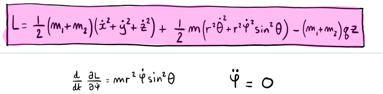

Your result for the equation of motion for ##\varphi## is not correct. (See attached picture below). You should find that the corrected differential equation for ##\varphi## can be easily integrated to get an expression for ##\dot{\varphi}## in terms of ##\theta##. You can then use this to eliminate the ##\dot{\varphi}## in the above equation for ##\ddot{\theta}##.
Note that you are only asked to come up with a specific solution to the equations of motion, rather than having to find the general solution.

Yes. You defined ##\vec{r}## to be the position of m1 relative to m2. (You could have chosen ##\vec{r}## to be the position of m2 relative to m1. Either way is fine.)
And ##\theta## is the angle between ##\vec{r}## and ##z'## while ##\varphi## is the angle between ##\vec{r}## and ##x'##?
What is the meaning of the primes here? In spherical coordinates, ##\varphi## is the angle between the x -axis and the projection of ##\vec{r}## onto the x-y plane.
  • Handwritten Lagrangian with a pink highlight: L = ½(m1+m2)(ẋ²+ẏ²+ż²) + ½m(r²θ̇²+r²φ̇²sin²θ) − (m1+m2)gz. Below it, the derivative d/dt(∂L/∂φ̇) = mr²φ̇sin²θ, and φ̈ = 0.
Thanks again for your answer. I'm pulling my hair on the equation of motion for ##\varphi##. I keep on getting
##\ddot{\varphi} \sin^2 \theta + 2 \cos \theta \sin \theta \dot{\varphi}^2 = 0##
but that's not what you seem to suggest (or is that easily integrable? Maybe I just don't know how to solve that). Note that I didn't simplify the sin so that you can still see the process through. I'm not sure how to integrate with two variables depending on time. :/
The last term isn't quite right. Instead of ##\dot{\varphi}^2##, you should have something else. However, think about where this equation is coming from. Doesn't it come from ##\frac{d[*]}{dt} = 0## for some expression ##*##? This is immediately integrable. If the derivative of something is zero, than what does that tell you about the something?
The primes refer to a cartesian coordinate system having ##m_2## for origin and with its axes parallel to the corresponding x,y,z-axes. A bit farfetched but it kind of help me to visualise which angles we were talking about. :)
OK, that's good. And I suspect your choice of orientation of the primed coordinate axes is what is expected. However, you are actually free to choose the orientation of the primed axes. If you choose the orientation in a special way based on the initial conditions, the equations of motion for ##\theta## and ##\phi## become very simple. But, for now, it's probably best to stick with your choice.
@TSny I am afraid I don't find where the mistake is. Here is what I have done in detail:
##\frac{\partial L}{\partial \dot{\varphi}} = m r^2 \sin^2 \theta \dot{\varphi}##
and with the use of the product rule:
##\frac{d}{dt} \frac{\partial L}{\partial \dot{\varphi}} = mr^2 \sin \theta \ddot{\varphi} + 2mr^2 \cos \theta \sin \theta \dot{\varphi}##
and ##\frac{\partial L}{\partial \varphi} = 0##. Do I differentiate wrongly or is something in my L missing something? I just notice the ##\dot{\varphi}## instead of ##\dot{\varphi^2}##, maybe the mistake was there?
##\frac{d}{dt} \frac{\partial L}{\partial \dot{\varphi}} = mr^2 \sin \theta \ddot{\varphi} + 2mr^2 \cos \theta \sin \theta \dot{\varphi}^2##
How do you get the ##\dot{\varphi}^2## in the last term. This term comes from taking the derivative of ##\sin^2 \theta## with respect to time. What do you get for ##\frac{d \sin^2\theta}{dt}##?
Yes. Since ##\frac{\partial L}{\partial \varphi} = 0##, your equation of motion is just ##\frac{d}{dt} \frac{\partial L}{\partial \dot{\varphi}} = 0##. Instead of carrying out the time derivative on the left, integrate both sides of ##\frac{d}{dt} \frac{\partial L}{\partial \dot{\varphi}} = 0## with respect to time.
And if I follow what you are saying, ##\frac{d}{dt} \frac{\partial L}{\partial \dot{\theta}} = 0## is what I should be integrating. I get from that ##\frac{\partial L}{\partial \dot{\varphi}} = mr^2 \sin^2 \theta \dot{\varphi} = const.## That would mean ##\dot{\varphi}## is constant? Not really sure about that.
@TSny I think I corrected the square on ##\dot{\varphi}## in my last post while you were answering. I also wrote the last post before reading your post.
Good. You have found a quantity that does not change with time. That will be helpful in answering one of the parts of the question.
No, you cannot deduce that ##\dot{\varphi}## is a constant from ##mr^2 \sin^2 \theta \dot{\varphi} = const##. Keep in mind that ##\theta## is a variable that could be changing with time.
@TSny Oh my god but I can deduce that ##\sin^2 \theta \dot{\varphi} = 1## and so that ##\dot{\varphi} = \frac{1}{\sin^2 \theta}## ! This homework is crazy :P Okay I'm going to try to get further with that...Julien.
