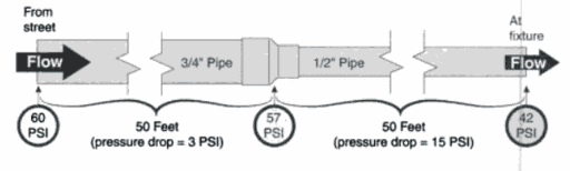

Hello and thanks again.
I found this picture in a plumbing book. The picture is supposed to show the pressure loss (drop) as the water flows in the pipe. What does it means that the pressure at the outlet is 42 psi? When the fixture is closed the pressure is 60 psi, the same as the inlet (head pressure)...
It means that it is connected at the outlet to something else that is not shown.
ok, thanks.
the picture says "at fixture", let's say a faucet.
What if there was no pressure drop, i.e. pipe and fluid were ideal? Would we have 60 psi all the way up to the faucet and then a quick transition from 60 psi to atmospheric pressure?
Yes, provided you neglect the effect of the change in cross section at the spot labelled 57 psi.
This is a self-contradictory set of constraints, leading to an answer that doesn't make sense. If you have no pressure drop you have no pressure drop and static pressure has to be atmospheric everywhere except when you have pipe sizing changes (then you apply Bernoulli's equation). Perhaps you meant no pressure drop in the piping and then a large obstruction in the faucet, in which case Chet's answer is correct. But then the question is basically asking "if you don't have pressure drop anywhere except where you have pressure drop, do you have pressure drop there?" Sure.
Either way, domestic piping systems are a prime example of where such assumptions lead to badly wrong answers about real life flow in them.

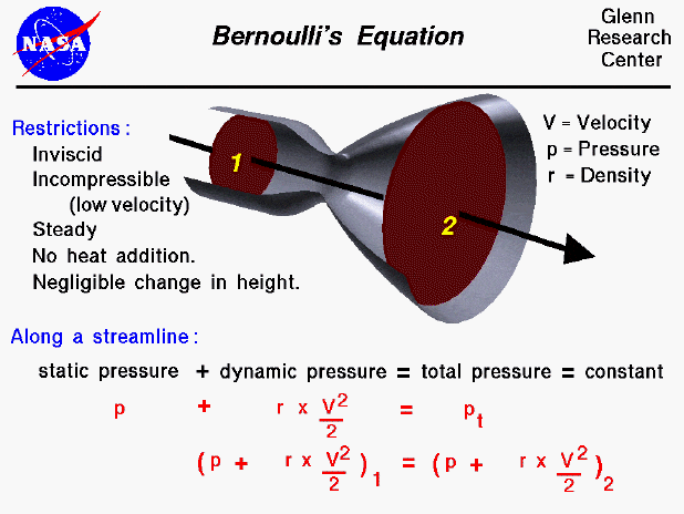

By "ideal" I mean an inviscid, incompressible fluid flowing into a perfect pipe. Bernoulli principle applies under these conditions (and along the same streamline. Why does it need to apply only along the same streamline?)

Typically, that means lossless too, as Chet said. You can add terms to handle pressure (energy) loss, but the basic Bernoulli's equations assume conservation of energy.
A streamline follows the path of a row of individual particles as they travel. Bernoulli's principle is a conservation of energy statement describing to what happens to a particle as it travels, so it can only apply along the path of travel.

I have been trying to understand "dynamic pressure". As you mention, there is hydrostatic pressure (which I understand as being isotropic and linearly dependent on depth), dynamics pressure and total pressure (which is the sum of static pressure and dynamic pressure). Dynamic pressure seems to be measurable using Pitot tube which converts it into a static pressure...
Essentially yes. It's only really "felt" when something gets in the way of the flow. The actual interaction is pretty complicated (the air in a pitot tube isn't moving, but the pressure is generated by air flowing around it...), but that's the gist of it. That's why drag is dynamic pressure times cross sectional area times a coefficient (essentially an efficiency at interrupting the airflow).

I have been reflecting more about static and dynamic pressure and here are my thoughts:
1) Static pressure is the pressure that develops in a fluid at rest. Static pressure is isotropic at a point, is linearly dependent on depth, and is always perpendicular to a surface regardless of its orientation.
2) In the case of an incompressible, inviscid fluid flowing in a pipe, the "static" pressure decreases where the fluid velocity increase (Venturi effect). The pressure is called "static" in this case as well even if the fluid is actually moving. Why is it called static? Its value is surely different from the static pressure described in 1).
My explanation is that a manometer measuring this type of static pressure is formed by fluid contained in a tube that is perpendicular to the fluid flow direction. The fluid in the manometer is actually at rest and determines a pressure on an internal surface of the manometer. The value of this static pressure value depends on how fast the fluid is moving longitudinally along the pipe.
3) Total pressure for a moving fluid is equal to the static pressure + dynamic pressure. a Pitot tube can measure dynamic pressure by subtracting static pressure from the total pressure. The Pitot tube has two sections. One section is perpendicular to the fluid flow and works like a standard manometer measuring the "static" pressure as described in 2). This pressure is the p in Bernoulli equation. The other section of the Pitot tube is instead longitudinal to the flow. The moving fluid enters that longitudinal section which has a dead end. The fluid reaches the dead end and stops forming a stagnation point. The pressure at the stagnation point is related to the momentum of the fluid before it collides and stops. Why does the pressure at the stagnation point also have a static component? This static pressure is not the static type of pressure that would develop when the fluid is at rest...
