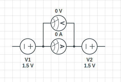

Hello, I can't image what is the exact path of electrons in two or more batteries conncted in series... if electrodes are immersed into the electrolytes and chemical reactions should continously happen why the circuit in the picture down here has no activity ?

Connect the two outside points with a resistor so current can flow. Your ammeter will then show that current, which is V/R.
The resistance of an ideal ammeter is zero, so your voltmeter will not register anything, even if a current is flowing. A real ammeter has a small resistnce, so the voltmeter will measure a small voltage across it when a current is flowing through it.

The chemical reaction in the electrolyte doesn't start till the circuit between the positive and negative terminals of the battery are connected ( ignoring the small loss caused by the internal resistance of the battery ... which of course gives it a limited shelf life)

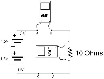

look again at the drawing I did for you in the other forum and I post again here
for how to connect up meters correctly to measure voltage and current
there MUST be a complete circuit path external to the battery(ies) before current will flow
