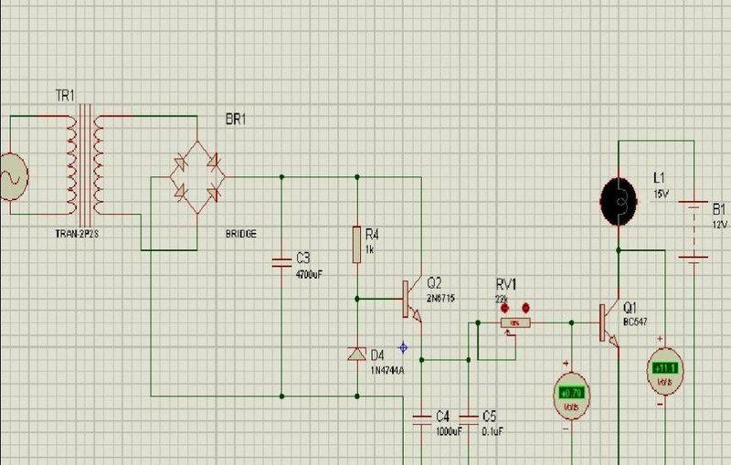

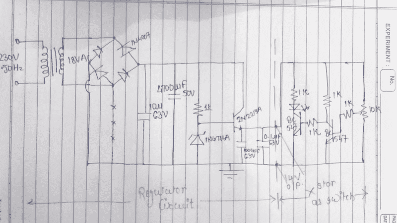

Hello friends I'm new here and want some answers from u. please help me to sort out the problem related to my circuit of high voltage protection. in this circuit i regulate the dc voltage using zener diode and then output of zener is given to the base of npn transistor. please check the circuit diagram for detail.
now coming to my problem that at second stage where i used transistor as a switch, actually transistor is not working as a switch. the led shown there must be ON/OFF but its nor happen here. when i changed pot value thn intensity of the LED changes only it not goes ON/OFF.
can anyone help me regarding this?

it would have been easier to read if you had posted the image the right way up
here I will do it for you...
What is the zener type ... I cannot read the full part number
there's no need for the first 10uF 63V when you already have a 4700uF there
so what are you really trying to achieve in the second stage ?
OK after a little figuring out ... the reason that the LED isn't switching off is because you have a continuous bias on the base of the transistor that the LED is in the collector cct.
That bias voltage(current) is coming from the positive rail down through the 1k resistor and on to the base
To make the BC547 a pure on/off switch then get rig of the second transistor and trimpot and other assoc components. Keep a single 1k resistor in the base and take that via a switch to the positive rail

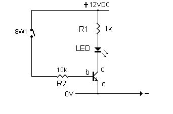

OK revising your stage 2 circuit
just a quick circuit I had drawn for some one else in days gone bye, but it will give you the understanding of how to use the transistor as a switch
You can still take the positive and negative rails from your PSU in your stage 1 circuitDave

Thanks Dave for ur reply..I'm using 1N4744 zener. and in the second stage i want a transistor to work as a switch only by using which i can operate relay. another modified diagram I/m attaching here. please check it

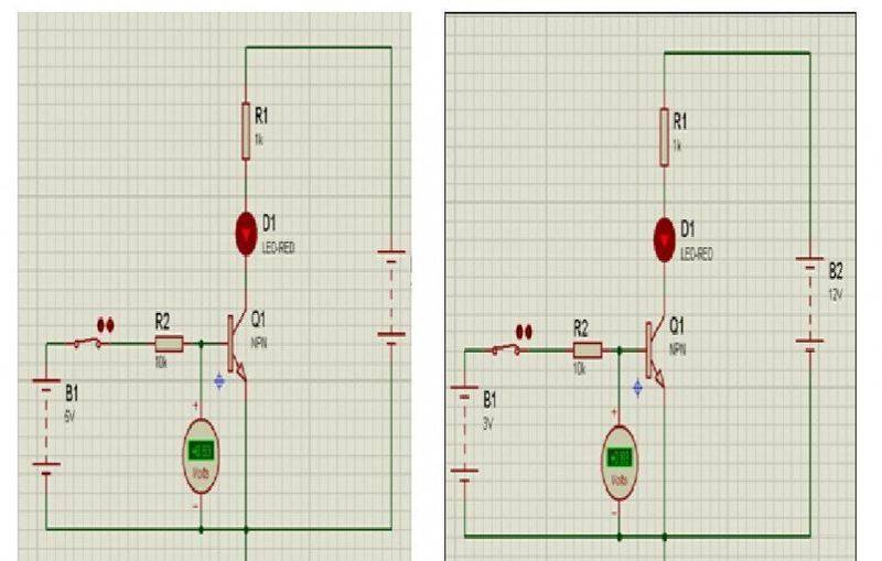

hei davenn I did as per ur circuit. but u can see in the simulation circuit runs for 3volt and also for 5volts. i checked it for 8volts also. if my DC voltage is varying from 8-14 volts as per AC mains changes from 180-250Volts this switch is continuously ON. but i want this to ON only After 7-9volts. den i can operate relay. otherwise it is not of any use.

seemasdawange said:
Why u use switch here.? i don't want anything which will work manually. i want this circuit to use in remote place. Thanks for ur kind help.
so what is the point of the trimpot ? it cannot be operated manually any easier than a physical switch
what do you intend to use to turn the transistor on and off ?
that isn't really clear
I have further circuit which i need to operate. I'm designing this circuit for high voltage protection. here at the output of transistor i want to connect relay which then further operate to protect my circuit by cutting it OFF from main source.
i'm using trimpot and fixing it to some value at which transistor ON. as voltage increases or decreases our resistance of trimpot is fixed and so current varries. which causes our transistor to ON or OFF as resistance is constant in this case. Getting my point?:sorry:
