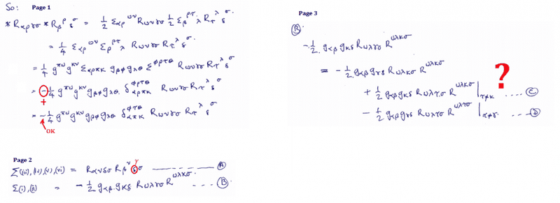

This is Exercise 15.2 in MTW - See attachment
See attachment
[/B]
My attempt at a solution is also in the attachment.
Are my initial assumptions OK? If not can someone nudge me in the right direction.
If my initial assumptions are OK, then I've gone wrong somewhere in my workings. Can anyone give me a pointer as to where I have gone wrong.TerryW

Terry,
I looked at your work and it looks good to me all the way through to your expressions (A) and (B). In the attachment below, I noted a couple of minor typos.
I believe your results for (A) and (B) are correct. They appear to be corroborated here: http://arxiv.org/pdf/1006.3168.pdf (see equation 1).
I don't follow how you got your expressions for (C) and (D).
So, it seems that you are left with showing ##g_{\kappa \delta} R_{\omega \lambda \gamma \sigma} R^{\omega \lambda \kappa \sigma} = \frac{1}{4} g_{\gamma \delta} R_{\omega \lambda \tau \sigma} R^{\omega \lambda \tau \sigma}## for the vacuum.
This identity is mentioned below equation (1) in the link above. I have spent quite a bit of time trying to prove it but have not been successful. The only vacuum condition that I can think of that would be useful is the condition that the Ricci tensor be zero. But, I haven't been able to use that to get anywhere.
If you crack this nut, please post it.
[EDIT: After looking further into the paper in the link given above, it appears that the paper does provide a proof of the identity ##g_{\kappa \delta} R_{\omega \lambda \gamma \sigma} R^{\omega \lambda \kappa \sigma} = \frac{1}{4} g_{\gamma \delta} R_{\omega \lambda \tau \sigma} R^{\omega \lambda \tau \sigma}## for the vacuum. The proof is somewhat sprawled out in the paper, but a key part of the proof is in the discussion surrounding equations (16) - (18).]

Hi TSny,
Many thanks for spotting the typos, but most of all thanks for confirming that my process up to (A) and (B) is correct.
As for (C) and (D), I was trying to find a way forward and arrived at that equation by the brute force method of writing out the values for the indices for κγκ in the expression (B) and comparing them with the indices γκκ in the expression I need to arrive at. What I observed was that the two sets of indices had a common set of four components (000, 111,222,333) and that the remaining 12 components of expression (B) could be written as gαβgδRωλτσRωλτσ(τ≠γ).
So I add these 12 values to the (negative) expression (B), but then I only have four of the required components of my target expression so I have to subtract a further twelve components provided by gαβgκδRωλτσRωλκσ(τ≠κ).
Not very elegant I admit, and it didn't lead anywhere, so let's dump it!
Thanks particularly for the reference to the paper. As you have pointed out in your edit, it does appear to provide a proof of the Lanczos identity, and given that Lanczos died in 1974, aged 81, it is likely that this identity was around when MTW was being written (1972), though I don't think MT&W would have been expecting the reader to know it!
All considered, a fairly tough problem, so I'm not too upset about not finishing it!Regards

Taking out the -¼gαβ, δλτδμφRλμγσRτφδσ leads to δμφRλμγσRλφδσ which leads to RλμγσRλμδσ.
The index γ in Rλμγσ means you can't use gγδ as an index lowering device, you have to use gκδ on Rλμκσ, which is where I came in originally!
As TSny said, it's all very headache inducing!RegardsTerryW
