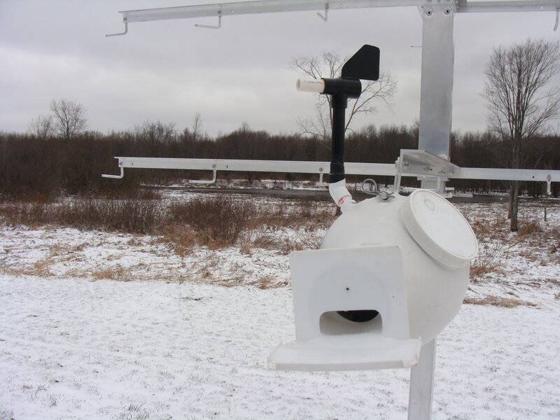

First off don't quit reading if you understand basic Bernoulli effect. I am nowhere close to the caliber of minds on this forum but I have a problem and lack understanding that science may help answer.
Preface: Temperature extremes are stressing wildlife populations. I happen to be an advocate of one species, the Purple Martin (PUMA). The PUMA nests almost exclusively in man made housing. With rising temperatures nestlings are stressed. The PUMA is in perile. I am attempting to come up with a "better mouse trap" for venting this housing to increase brood survival.
I would like to apply the Bernoulli effect but am uncertain how. The vent is essentially a small funnel wind vane that faces into the wind. Wind would come into the funnel and cross over a hole that comes from inside the housing. My hope is that this will create a vacuum in the house pulling hot air from the nest cavity out the funnel. Is my theory sound? I also don't even know whether to face the large or the small diameter of the funnel into the wind ? Any help or suggestions greatly appreciated.

Baluncore, suggestions with the proper length of tube and funnel would be helpful. Attached are some pics of a protype I've been using (successfully). I am also attempting to combine Bernoulli with what I call "smoke stack" effect. I'm sure there's a better name for it.

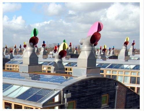

Regarding the device shown in your picture in post #5, it seems to be two L-shaped ducts (inlet and outlet) mounted on a gyratory common platform rather that a venturi (Bernoulli) effect.
Copied from
https://sustainabilityworkshop.venturewell.org/node/1029.html
"For example, the specially-designed wind cowls in the BedZED development use the faster winds above rooftops for passive ventilation. They have both intake and outlet, so that fast rooftop winds get scooped into the buildings, and the larger outlets create lower pressures to naturally suck air out. The stack effect also helps pull air out through the same exhaust vent."

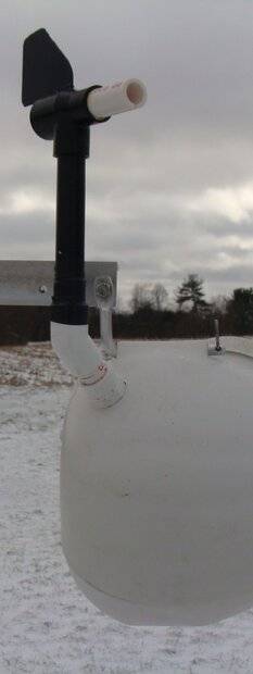

From your pictures of the actual nest in post #4, it seems that the venting device can't orientate itself toward the wind, as it seems to be a simple PVC tee.
It may be manually oriented into the prevailing wind direction.
Are my observations correct?
Also, is the entrance of the nest the only way for fresh air to come inside?
Any means to drain the nest in case wind-driven rain penetrates?

Lnewqban, The "T" coupling or "vane" sits loosely on the vertical pvc so it is able to orient into the wind. It works well.
There are 4 small weep holes at the bottom of the nest cavity for drainage. Nesting material stacked on top make them ineffective for ventilation. The manufacturer of this style of house (aka gourd) has two approx. 1/8" holes at the top to allow hot air to escape. Not sufficient IMO. Mortality in my bird colony is much higher during spells of hot weather. Young birds still unable to fly actually fall or jump from the gourds. In the PUMA community they are called "jumpers":oldfrown:.
I had thought about wind driven rain in my design. That is the reason for the pvc horizontals extending from the "T". Not shown in the pics is that I cut weep holes on the underside of these extensions to allow for drainage prior to reaching the vertical down pipe. After two seasons of monitoring, I've had no moisture infiltration into the nest cavity.
Any thoughts on how I could teak this design to make it more effective? I appreciate all the feed back.

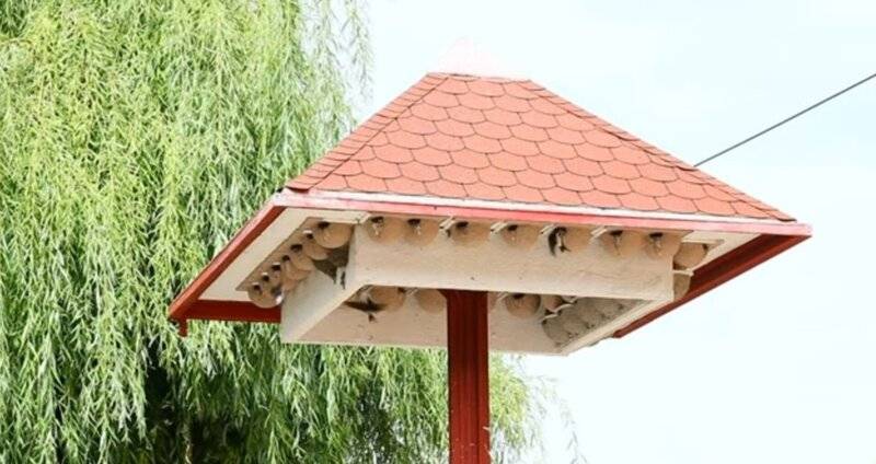

I do understand that. What I'm wondering about is, that maybe it would be more effective to modify the placement of the "mouse trap" instead.
We have some kind of similar issues with decreasing population of (barn & other) swallows, and while we too came up with various types of artificial nests, a common trait is that none (!) of those gets direct sunlight, ever.
I know that purple martins are not barn swallows, but these 'gourd-trees' still looks (very!) weird for me, especially in the context of heat management.
What we have (for open areas) are like this (mind the placement, not the size!):
Ps.: if you are decidedly only after ventilation improvements then sorry, and I just won't bother you again with these

Your first picture happens to be the same as one of my units. If you look closely to the pic you can see these after market pvc elbow vents.

For a tapered vent, a 'crevice tool' for a vacuum cleaner is one idea; probably too expensive though. The one I just measured has a circular area (for hose attachment) of 1.2 sq.in. with the flattened end area of 0.33 sq.in. The taper, though, is only 1 in. long, so a bit sudden.
Another possibility is PVC 'pump discharge hose'. Check the Big Box hardware stores for some. It runs about USD 1.70 to 4.00+ per foot. The corrugated style is moderately stiff, available in 6-foot lengths, and could probably be shaped after heating in boiling water.
Have Fun!
