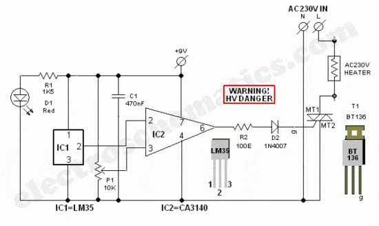

I am a good DIYer, so I know I have the skills to solder a circuit together, but I can't design anything! Hoping a kind soul here can shed some light.
I have a space heater that is being used to heat a very small space, and the problem is that on its lowest setting once the area comes up to temp there is still so much residual heat left in the heater that the area coasts up a few more degrees than desired. I want to design a 120v circuit that will cycle the heater on and off, effectively reducing the power output. For example, on and off every 30 seconds may be a good place to start, or on for 20 seconds and then off for 40, continuously. It has to be mechanical, or analog, meaning, it can't use any kind of logic because when the desired temperature is reached the power is removed (its hooked up to a temperature-sensing relay).
Thanks!

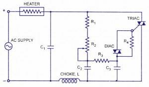

Something like this, I reckon?
This one is a bit more sophisticated, and uses a temperature sensor (LM35) to control the heater. By the way, BT136 will only support a pretty small heater (4A @ 110V = 400W); you'll probably need a bigger TRIAC.

If you can't find a simmerstat then following on fsb, get a simple triac dimmer meant for lighting at the hardware store. Mount it in a junction box with an outlet and you're good to go.
Make sure it's rated for at least the wattage of the heater but 1500 watt dimmers are common and cheap.
thanks for the great suggestions! i originally wanted to build a circuit and the simmerstat looks great, but the idea of just hooking it up to a dimmer has sort of blown my mind w/ its simplicity. Tomorrow I'm going to try just that, and i'll put my kill-a-watt between the circuit and the outlet and see how effectively it reduces the output.
