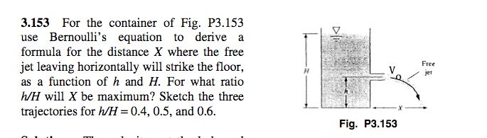

X=Vo*tfall
Bernoulli Eq: [tex]\frac {p}{\rho}+\frac{V^2}{2}+gz=const[/tex]
I used B.E. to find an expression for the velocity of the exit jet:
[tex]V_o=\sqrt{2g(H-h)}[/tex]
For some reason I am confused as to how to find an expression for t_fall ?
I know it should be easy, but I am under the impression I am supposed to use the B.E. to find it...
Any hints?
That's not how I read the problem. You've used B.E. to find V0. The rest is just projectile motion.
Oh. Easy Enough then :smile:
Thanks again Doc!
t=sqrt(2h/g)
