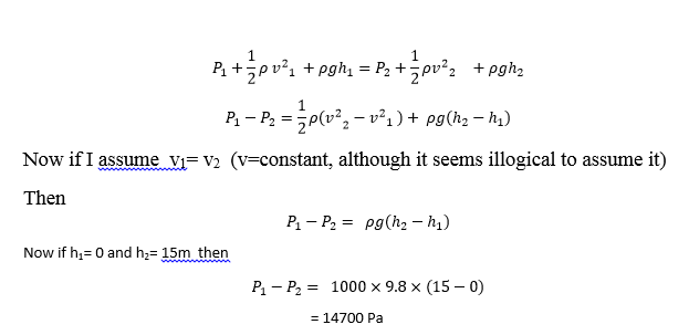

What gauge pressure is required by city mains for a stream from a fire hose connected to the mains to reach a vertical height of 15m?
Bernoulli Equation:
on Phys.org
My objection on this solution is taking v= constant. I think velocity should be zero when water reaches the highest point of 15m. Only then we will find the minimum pressure. I have seen an alternative solution by using simply P=pgh , but my query is how Bernoulli equation reduces to this relation (P=pgh)? Please help on this.

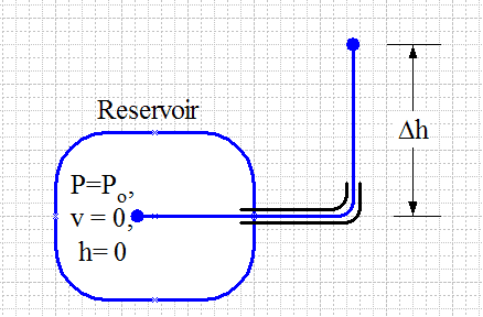

You can place the starting endpoint of the streamline inside the source reservoir (city main) where the velocity can be taken to be effectively zero. That way your velocities will be equal yet satisfy your objection :smile:

In a picture:

No, only two points are required on a continuous streamline. Bernouolli is an energy conservation equation, and thus so long as no unaccounted external forces or energies affect a parcel of fluid from one end to the other of the streamline you can ignore the details of pressure and velocity changes along the way.
If you use the pressure at the hose exit as a starting point, you won't be using the mains pressure. The moving fluid there will already have a lower pressure than the mains pressure.

Sorry, but helpers can't write the equations or do the work for you here (forum rules). But I can give you the hint that you can write the Bernoulii equation for the two stream endpoints that I indicated on the diagram that I posted. I've even indicated the pressure, velocity, and height parameters for the starting point.
