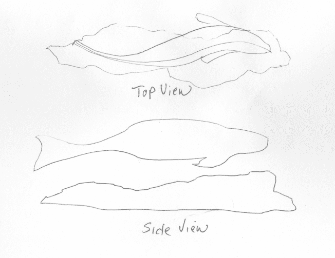

First a brief history of the work I want to do. In 1978 I carved a catfish out of walnut which included a large rock base and a mix of brass and bronze rods for barbels and a pivotal mounting system between the rock and the walnut catfish. Today I want to do a similar creation except I want to use some urethane foam (to carve the fish), a rock as a base, and the proper placement of electromagnets in the rock base and regular magnets inside of the urethane foam fish.
The idea here, if you haven't already guessed is to create the state of the fish floating in place above the rock. I know pretty much nothing about how to do this, except that the magnetic poles should be the same to create a rejection field (my term) between the rock and the fish. Perhaps there might even be some additions of opposite poles to create an area of attraction, but I don't know.

Can you post a sketch of what you want it to look like? (Use the Upload button to attach a PDF or JPEG file to your reply.) Do you want the fish to be "floating in air" above the rock using magnetic forces?
Yes, the design is to have the rock as a base and the fish to be floating above the rock to give the look of the fish swimming over the rock, float in the air or virtual water. The length of the fish at this point is about 3 feet or so, the rock about the same. The fish will have a classical "Greek S" design which will give it a sense of motion.

This Wikipedia article is a good place to start: https://en.wikipedia.org/wiki/Magnetic_levitation
As you can see in the article, if you follow the link to Earnshaw's Theorem, you will see that it's probably not possible for this to be built with just permanent magnets (there is a stability problem in the position of the levitated fish).
A more straightforward way would be to use eddy currents on some metal structures inside the fish to keep it levitated above the rock. Can the rock portion of the sculpture have an AC Mains power cord running to it? If not, can it contain moderate-sized batteries that get recharged each night?
