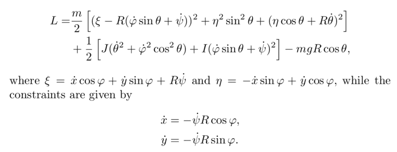

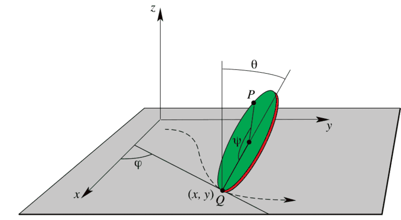

I think it would be a good exercise to write down equations of coin's rolling without slipping on a horizontal table and study stability of its straight vertical motion in the linear approximation.
to begin with:

##\boldsymbol{q} = (x,y,\varphi,\psi, \theta)##\begin{align*}
\dfrac{d}{dt} \left( \dfrac{\partial L}{\partial \dot{\boldsymbol{q}}} \right) - \dfrac{\partial L}{\partial \boldsymbol{q}} = \lambda \begin{pmatrix} 1 \\ 0 \\ 0 \\ R\cos{\varphi} \\ 0 \end{pmatrix} + \mu \begin{pmatrix} 0 \\ 1 \\ 0 \\ R\sin{\varphi} \\ 0 \end{pmatrix}
\end{align*}Too tired to evaluate the gradients.
I would use D'Alambert-Lagrange
$$[L]_\theta:=\frac{d}{dt}\frac{\partial L}{\partial \dot\theta}-\frac{\partial L}{\partial \theta},$$
$$[L]_\theta\delta\theta+[L]_\psi\delta\psi+[L]_\varphi\delta\varphi+[L]_x\delta x+[L]_y\delta y=0$$
$$\{(\delta\theta,\delta\psi,\delta\varphi,\delta x,\delta y)\}=span(a,b,c)$$
$$a=(1,0,0,0,0),\quad b=(0,0,1,0,0)$$
$$c=(0,1,0,-R\cos\varphi,-R\sin\varphi)$$
