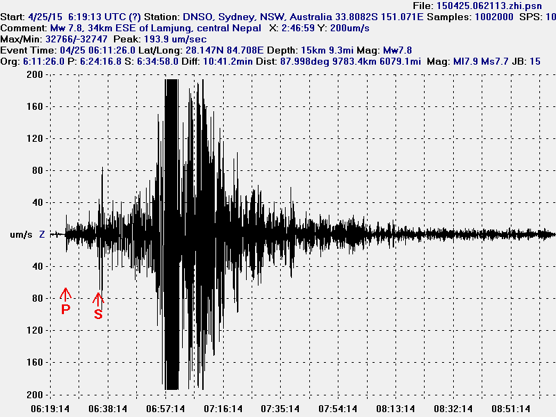

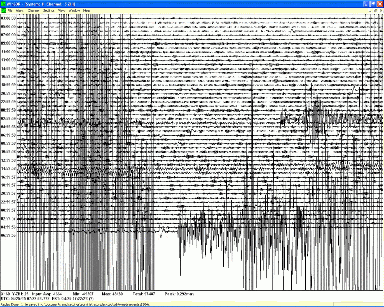

OK a couple of seismograms ...
The first one is a raw screen dump taken just prior to the trace overwriting itself
this second one is the processed version with the quake info data added ( timing, depth, location etc)
you can see at the around the 0657 time area that the surface waves were overloading the 16 bit analog to digital converter

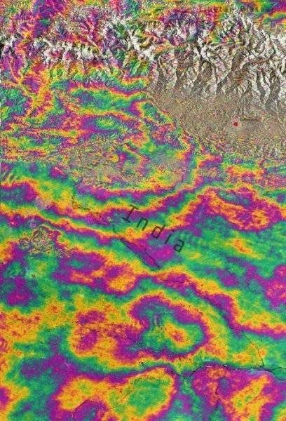

Fascinating images coming in from the ESA.
NEPAL EARTHQUAKE
Released 29/04/2015 4:50 pm
Description: Combining two Sentinel-1A radar scans from 17 and 29 April 2015, this interferogram shows changes on the ground that occurred during the 25 April earthquake that struck Nepal. An overall area of 120x100 km has moved – half of that uplifted and the other half, north of Kathmandu subsided. Vertical accuracy is a few cm.

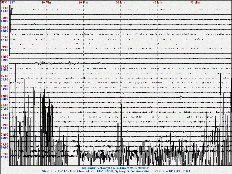

Another large quake in Nepal, M 7.3, located around 150 km east of the M 7.8 last month
I don't think it would be correct to call this an aftershock of the 7.8, as it lies well outside the aftershock zone of that event
http://www.sydneystormcity.com/seismograms.htm
It would be much more likely and better to call this a new event, but induced by the changed stress field in the region after the 7.8 Knowledge of these changing stress fields in fault lines after quakes is not new, They came to prominence particularly after the M 6.7 Northridge, California quake of Jan 1994, where remote imaging from satellites clearly showed how the new stresses had moved to the regions beyond either end of the rupture zone. Nothing has happened in those regions in the last 20 years and one would assume ( sometimes a bad thing) that existing stresses plus the addition stress is not enough to cause a new rupture yet.
Considering the large size of the event last month and the relatively rare occurrence of suck events in this region, it would be easy to conclude that significant stresses in the plate boundary along the Himalayan front have been building for a long period of time, 100+ years. And that, unlike the Northridge situation, it didn't take too much more change in the stress field to the east of the 7.8 to tip the balance and allow this M 7.3 to occur.
It will be interesting to see in time if studies are done of these events by the USGS or universities, if they show the changes happening in the region
Regards
Dave

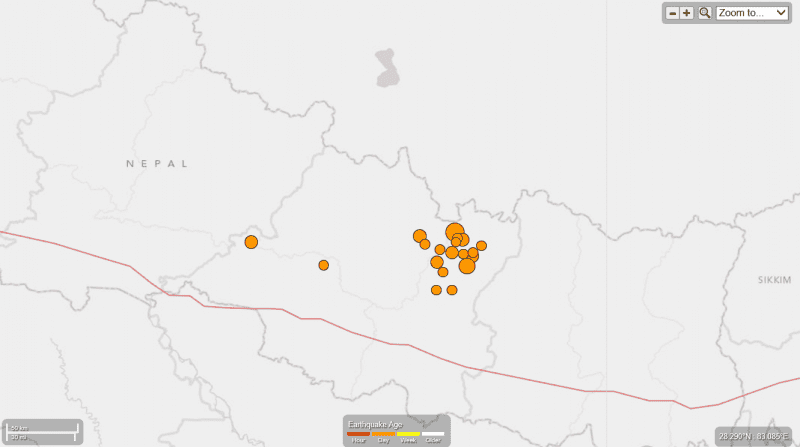

Here's an image of the earthquake locations today. The largest circle is the mag 7.3.
I'll add a list later.
