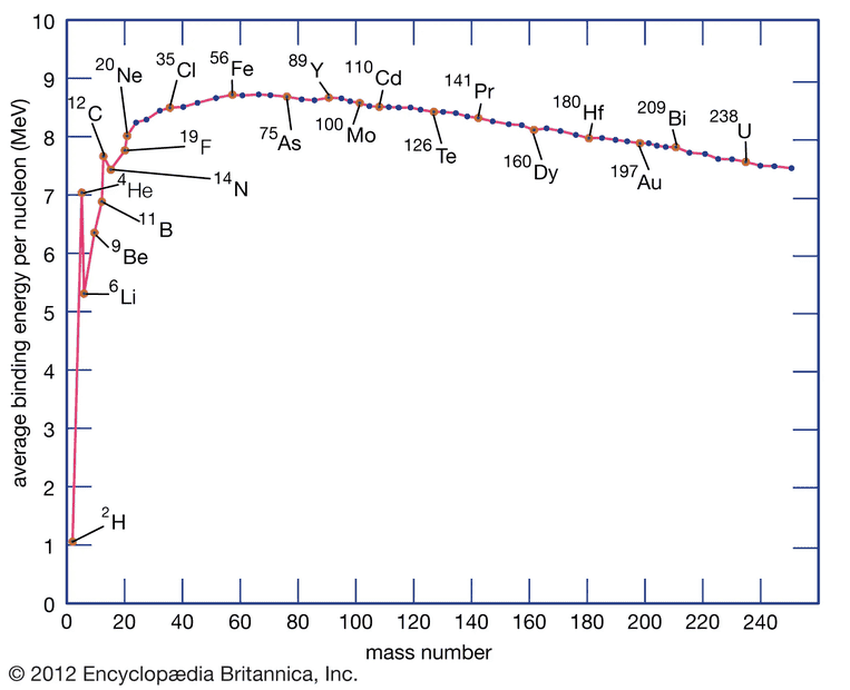

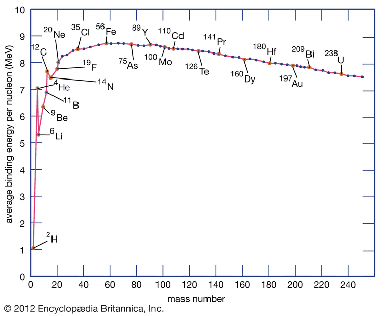

If I am not mistaken, binding energy is the energy required to separate the constituents of the nucleus, and is always a positive number. However, if splitting elementary particles in the nucleus apart requires energy, then why do fission reactions release energy?

The thing is, you always need energy to split a nucleus into lone nucleons.
However, if you split a nucleus into, not exclusively lone nucleons but into one or more other nuclei (plus lone nucleons left over), you can compare the binding energy of original nucleus with the binding energy of final nucleus, or sum of the binding energies of final nuclei if there are several final nuclei.

The note about total mass of bound particles is the key. The sum of the masses of the fission products is less than the masses of the exited 236U nucleus.
hyperphysics.phy-astr.gsu.edu/hbase/NucEne/fisfrag.html
http://hyperphysics.phy-astr.gsu.edu/hbase/NucEne/nucbin.html#c4
Pick two complementary fission products, add their masses, and subtract the mass of the 236U nucleus, or sum of masses of 235U + n.

Wow this result is impressive. May I ask you to try to explain the reason behind the drop in the total mass, please?

Total mass drops if, and because, the total binding energy increases.
You could pick a pair of complementary fission products where the mass does not decrease. Such as Pa-234 and D (plainly complementary fission products!). You would find that those fission products only have nonzero yield with fast neutrons.

Nuclei are held together by the strong force -- which is strong, as the name says, but has a very short range. So in bigger nuclei it has relatively more difficulty overcoming the Coulomb repulsion. Hence the downward slope for larger ##Z## in your picture in post #3. And energy = mass.

So more pions relative to the number of protons in the heavier nucleus?

The OP was asking about binding energy and how it related to energy produced from fission. That question has been answered.
The wording was "why do fission reactions release energy".
One possible answer is "because reactions which do not release energy are called something else than fission, such as spallation". Another possible (but not quite correct) answer is "because reactions which do not release energy do not happen".
Trying to explain fission by reference to binding energy curve, my tangent was to point out low yield of fission products around the peak of binding energy curve. Why don´t we see more of reactions like:
U-235=Hf-187+Ca-48
U-235=Gd-171+Ni-64
U-235+n=4V-59?
