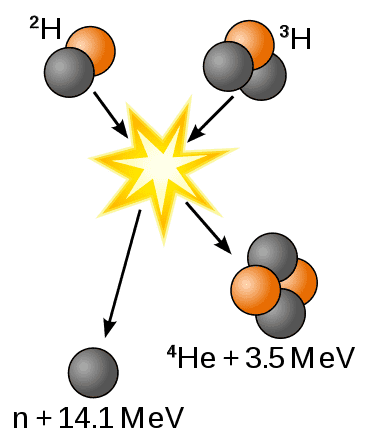

Summary: I always confuse Binding Energy with Released Energy in such processes. Which one comes from mass defect?
For example in a Deuterium-Tritium fusion two nuclei with lower binding energy converse to He-4 with much higher binding energy (and a neutron). The released energy is 17.6 MeV.
What exactly happens to mass defect?
Is it conversed to the higher binding energy of ∝-particle
or the released kinetic energy of the products?
Anyone could help me with this problem?
Fusion of deuterium with tritium creating helium-4, freeing a neutron, and releasing 17.59 MeV as kinetic energy of the products while a corresponding amount of mass disappears, in agreement with kinetic E = Δmc2, where Δm is the decrease in the total rest mass of particles....This difference in mass arises due to the difference in atomic "binding energy" between the atomic nuclei before and after the reaction.
Isn't it a contrast?!:confused:

You're confused because you're double counting. It's not that mass defect is spent on changing the binding energy - it is the difference in binding energy. More tightly bound means less massive. That difference is then emitted as kinetic energy or radiation.
So, let's say we have the reaction shown in the picture:
##m_d, m_t, m_h, m_p, m_n## - rest masses of deuterium, tritium, helium, isolated proton, and isolated neutron respectively.
##E## - released energy
##B## - binding energy
now:
##m_d=m_p+m_n-B_d##
##m_t=m_p+2m_n-B_t##
##m_h=2m_p+2m_n-B_h##
and the fusion reaction is:
##m_d+m_t=m_h+m_n+E##
here we could write:
##m_d+m_t-m_h-m_n=E##
##\Delta m=E## (*using natural units)
and conclude that all the energy comes from the difference in initial and final masses (mass defect),
or write:
##(m_p+m_n-B_d)+(m_p+2m_n-B_t)=(2m_p+2m_n-B_h)+m_n+E##
cancelling out all the rest masses of isolated nucleons we get
##-B_d-B_t=-B_h+E##
##-B_d-B_t+B_h=E##
##\Delta B=E##
So we can see that all the released energy comes from the difference between initial and final binding energies. It's the same thing, just more deeply understood.

Thank you very much!
