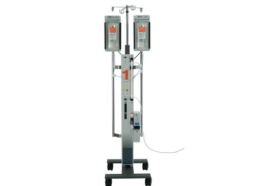

Fast-flow blood warmers (pictured below) can be used to heat blood products (carefully and uniformly) when rapid, high-volume transfusions are necessary, in order to prevent hypothermia in the patient. The blood product density and specific heat can be assumed to be 1.12 g/cm3 and 3.8 kJ/kgK, respectively. If the blood product initially is at 8 degrees celsius, the target temperature is 37 degrees celsius, and the maximum transfusion rate is 900 ml/h, what is the theoretical heating power (W) needed for this machine?
q=mcΔT
W=J/s
Density=m/V
Sorry, this is a new type of problem that our prof. gave, and he also gave no hint/formula so I am lost. Where do you implement the transfusion rate in the calculation? Do I treat it as the volume?
Use your first equation to find energy to heat the 900ml.
Use the second equation to find the power required to do it in one hour.
Or combine the equations to do it all in one step.
