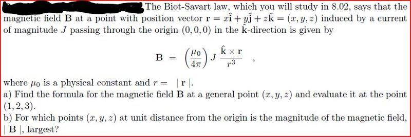

See attachment for Problem Statement.
Can anyone help me start this problem, or clarify what is being asked? I have no idea where to begin.
The first part is simply asking you to evaluate B in terms of x,y,z. This involves expressing [itex]\hat{k} \times \vec r[/itex] and r in terms of x, y and z.
In the second part the key is to determine when [itex]\hat{k} \times \hat r[/itex] will be maximum (cross product of the unit vectors in the k direction and the r direction).
