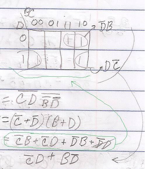

Hi,
This is a question about a boolean "law" type behavior I've noticed in my homework a couple of times.
Basically i can't find a boolean algebra law that permits this optimization short of using a k-map.
So I'm just wondering if theirs some way to optimize the one equation using just boolean algebra in order to get the second one (the output of the k-map).
Nvm i found it in the solutions for that homework.
It's called the "consensus theorem"
where:
xy' + xz' +y'z =xz' + y'z
Had a feeling it was some obscure identity/law lol
OK apparently theirs two or more forms: xy + x'z + yz = xy + x'z
found this one in a book, and matched wikipedia.
