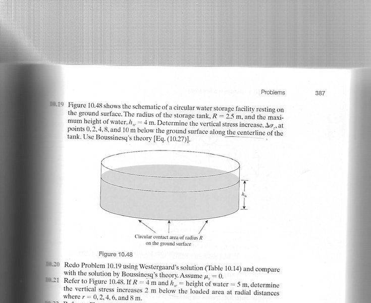

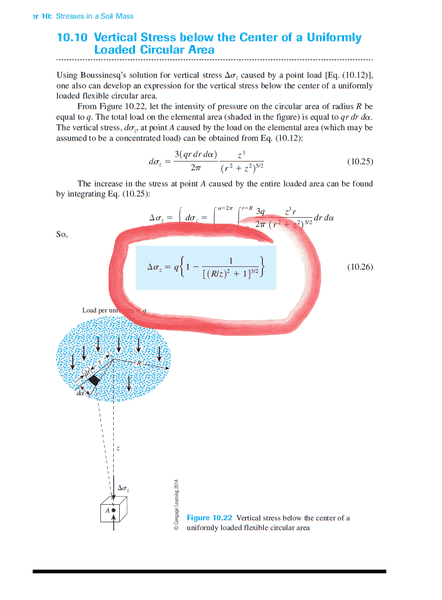

in question 10.19 , i use equation 10.26 to do the question . I have all the values of all variables , except q ( load per unit area) ...
How to get q ? It's not stated in the textbook . Is there something to do with the homework =4m ??
I assume q = h(unit weight of water0 = 4x9.81 = 39.2kN/ (m^2) . Am i right ? Correct me if i am wrong .

Correct.
