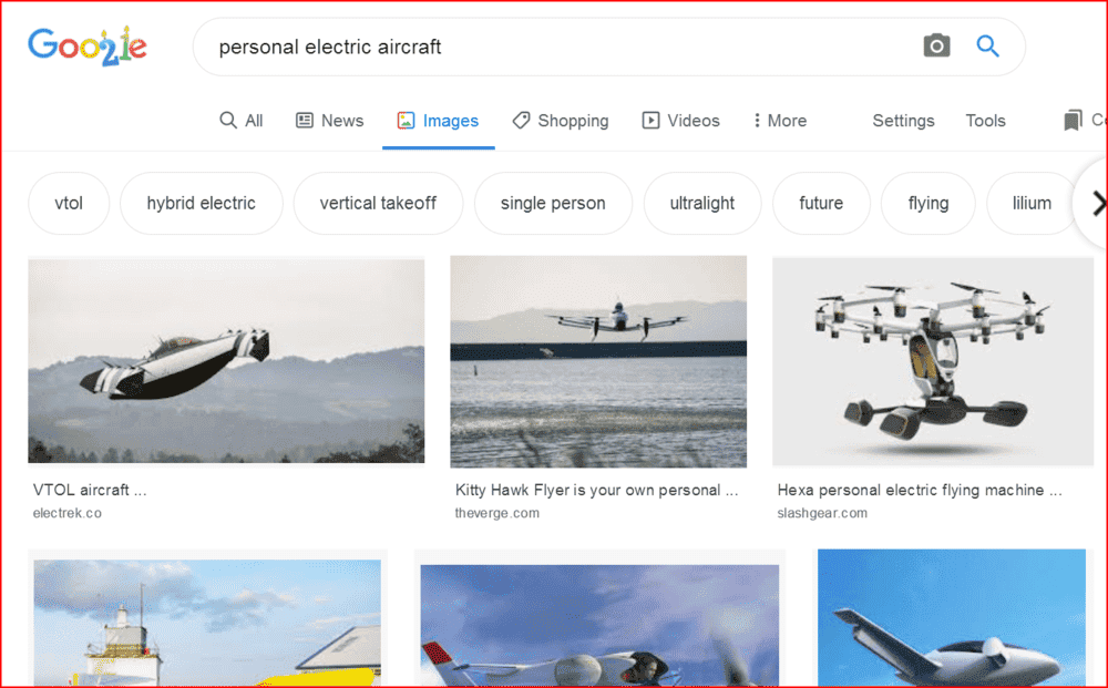

And I did a Google Images search on personal electric aircraft, and got some good hits. Do that search and look through some examples of designs, and think about why they are using those designs (like the number of vertical rotors...).

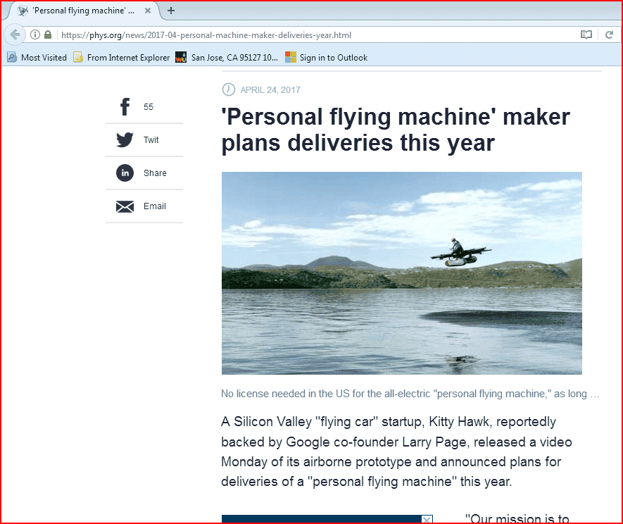

A few things seem obvious to me:
  1. You should be playing with RC quadcopters (you will learn much)
  2. The use of electric motors allows distributed lift because most of the weight is shifted to the batteries and the motors are relatively light weight.
    • I would sure like to have a redundant system where any single point failure would not kill me (maybe six lift motors where any three could keep you from disaster?)​
    • differential thrust allows you do all the control without any mechanical motion of the members under lifting load. Big rotating joints are heavy and electronics are not. Also moving rotating objects produces large and often unwanted precessional forces.​
    • If all thrust assemblies are similar the construction gets very much simpler (maybe an hexagonal configuration)​
The Kitty Hawk machine @berkeman looks fabulous and I want one! Hope this goes well.
Likes berkeman and BillTre
