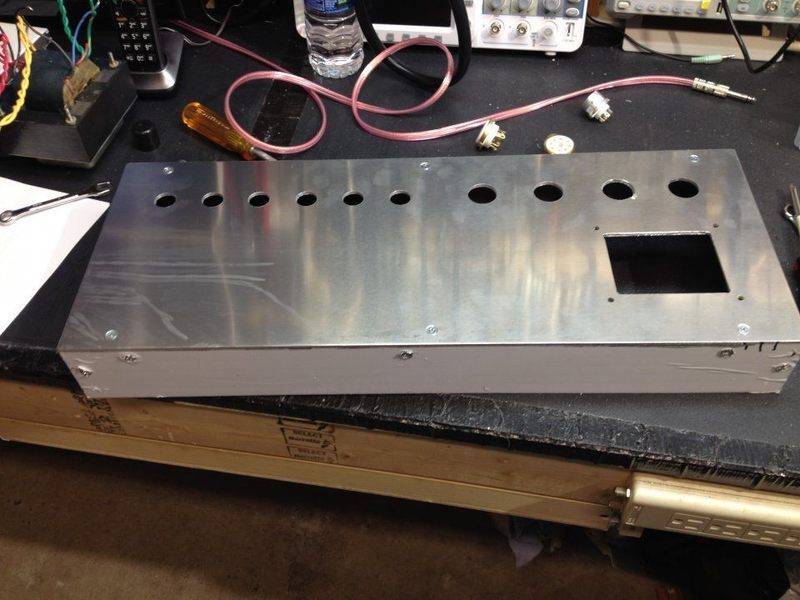

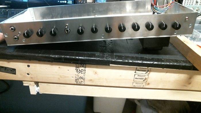

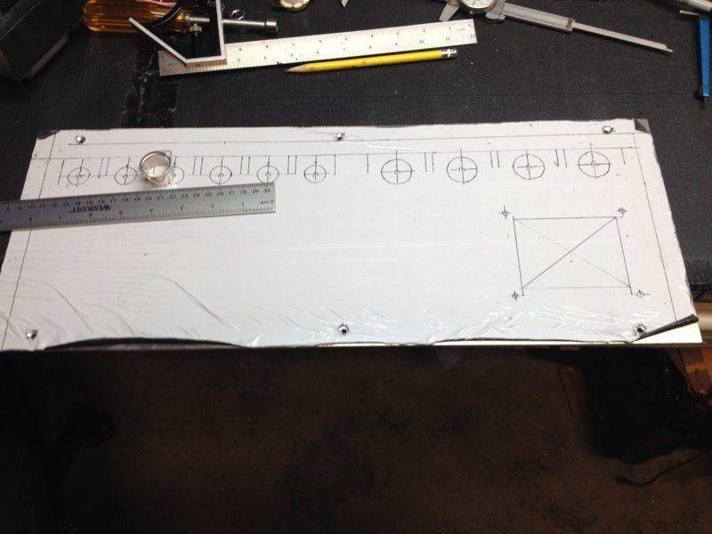

This is my first try at building everything myself. Programming the G Code to cut the chassis on my old Linux computer took a bit of thinking...lol Here is a short video.

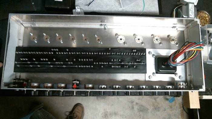

A few photos so far. I will post the schematic when I finish it.
White sheet of layout marked for an amplifier chassis on a workbench, with drill-centre circles and tick marks along the top edge and a rectangle with diagonals at lower right; a steel ruler and pencil lie above it.
Photo of an unpainted aluminum amplifier chassis lying on a workbench, with a row of round holes of different sizes and one large rectangular cutout along the top panel.

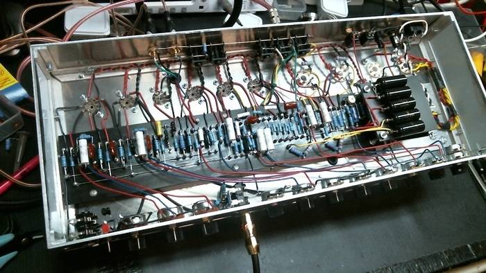

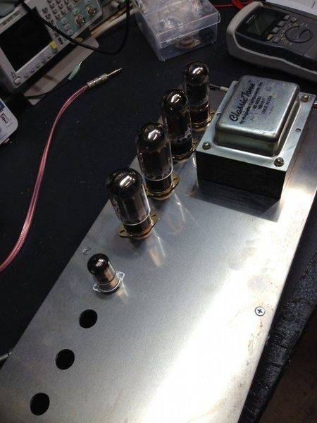

  • Photo of a partly built vacuum tube amplifier on a metal chassis: four large glass tubes with metal bases, a smaller tube, a ClassicTone transformer, and a few drilled holes, with test equipment in the background.

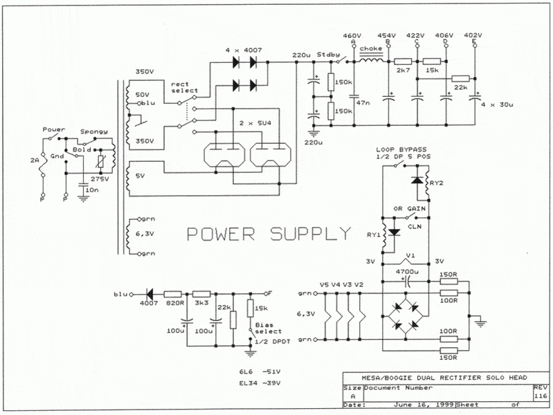

Hi Svein,
I have been thinking about this project for a while now. I wanted to build a chassis that could be used for several different designs and would lend itself to experimentation and ease of change. I am installing six Noval and four Octal tube sockets. The power transformer measured no load output is 731 VAC rated at 150mA, 367VAC center tap to each side for the HT. It has a 6.3 VAC @ 5A and a 5 VAC @ 2A tap. That will power most designs up to perhaps 50 plus watts.
I had in mind to build the power supply a bit like the Mesa Boogie Dual Rectifier with a switchable solid state bridge rectifier.
I had in mind to build two turret style circuit boards, one based around a Fender bassman http://schematicheaven.net/fenderamps/fender_bassman50.pdf
and the other based around a Fender Deluxe Reverb, http://schematicheaven.net/fenderamps/deluxereverb_II.pdf
All of this gives me the ability to use 6l6GC or 6V6 or 5881 or KT66 tubes with small changes to the basic circuit.
Well...that is the general idea at the moment. I also thought some of the guys here on the site might like to suggest some ideas. Nothing is set in stone at the moment.
The idea also was to see if I could build everything myself. There are a lot of different skills needed from woodworking/metalworking to computer programming to electronic design and others. How, for example do you make a instrument panel cover with nice writing? Easy I guess if you have a CNC engraving machine...I may be able to get and modify some software that will run my CNC mill for that.
None of this is turning out to be simple but it is a fun challenge and so far everything is going well. A few small mistakes in the machining that no one but me would know were there. I have not got G Code programming down very well...lol...at least I am not dealing with a thirty horse power machine that if you crash it can knock the building over..lol

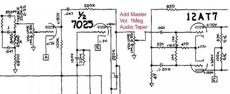

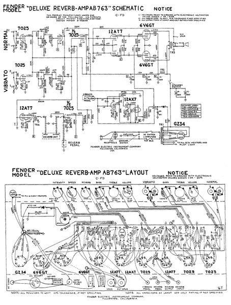

Here is the general design idea that I will build from. Finally made up my mind...lol
I have in mind to add several things to this basic design. There exist a output transformer that can be used with both 6V6 and 6L6GC tubes...still thinking if I want to spend the extra $200 to install that...lol
This is a design Fender came out with around 1965 also known as a Blackface.
Well done picking a design. I have to say that it is a complex one for a build with the vibrato and reverb circuits adding up to the equivalent of 3 preamp stages (in terms of wiring it up and getting it right).
I have just picked up an old Fender transistor amp that blew up and was rebuilt as a valve amp in 2009 by someone called Jason Sansome. He based it on the 5E3 Deluxe circuit and he clearly knew his stuff. The standard of the build is exceptional and the modifications are mostly sympathetic - and some surprising (like the EL84 output tubes). It sounds awesome even at living room volumes and it considerably louder than the rhythm guitarist's VOX AC15 at band practice.
The Fender sound isn't for me though so I am considering a Marshall 18W Plexi circuit for a build project. I will start that once I have re-tubed and biased the mongrel Fender which is going to the rhythm guitarist, so next month hopefully.
Good luck with your build. I will keep an eye on this thread with interest.
Hi Bandit,
Yes, the reverb and vibrato does add a bit of complexity, not to mention the fact I am building this as a head cabinet and have the issue of where to place the reverb tank. I like the sound of those two effect as produced by that type circuit. I am not so keen on other methods I have listen to for the same type of effect.
I just finished up a JTM 45 for someone but I have never built a 18W Plexi. I have repaired several 18W Marshall re-issues lately.
I am going through the AB763 circuit design at the moment to look for issues I may want to change. I will install both the GZ34 rectifier tube and a switchable solid state bridge rectifier. I am not sure at the moment if the if the 16uf filter/smoothing capacitors are the best solution and I have not got into the effect of the new added solid state rectifier as this will most likely change the filter cap requirements.

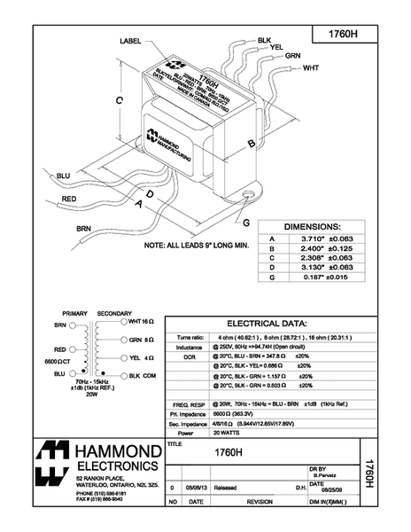

Fender used a power transformer that has a 45 VAC tap in the HT secondary and I have a transformer that does not have that tap. I can build a single diode circuit off the HT secondary of the transformer I have for the bias supply like Marshall does without issue...I assume...lol...not the end of the world to buy more iron if need be.
The major changes will include the use of power scaling based on a Mosfet design IF I have room to mount the two Mosfets on the chassis in a way to provide a good heat sink. If not, I will at least add a post phase inverter master volume control. The idea of being able to use either 6V6 or 6L6GC tubes appeals to me but there is a good bit of cost associated with the multi tap output transformer.

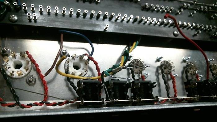

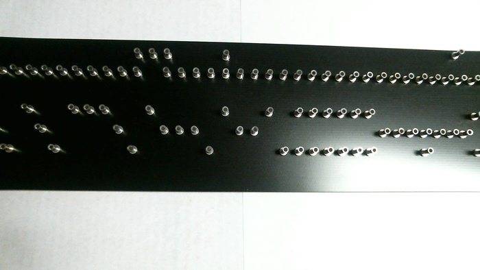

Update,

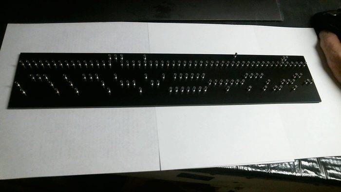

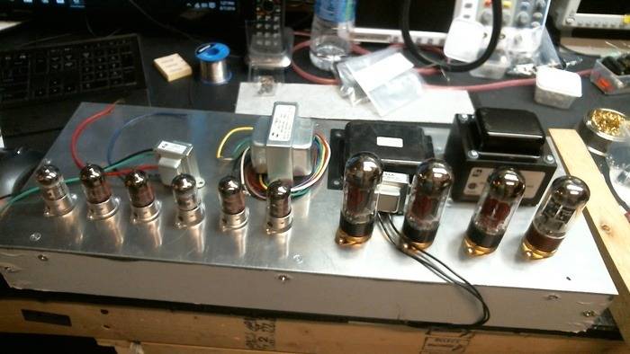

Building the turret board and the placement the components in the chassis has required a bit of rethinking and adjustment. I changed from the original power transformer to another one which will require an adapter plate as it has a smaller cut out dimension. More adventures in G Code for the CNC mill...lol I have yet to master the tool offset issues yet. If you want to mess things up, use a computer. If you really want to mess things up, have that computer direct the actions of a four axis milling machine...lol
I still have not made up my mind about the placement of the filter capacitors. Fender typically placed them on top of the chassis and contained them inside a cover plate on a small board. I may try to place them (there are five 16mf 475V caps) inside the chassis under the potentiometers...not sure yet.
Here is a photo of the almost finished turret board. The transformers will arrive tomorrow and I want to place everything before I drill the mounting holes in the turret board. There has been more time and work involved in defining a step by step build process than I assumed there would be. The electronic issues are proving to be easer to deal with than the logistics of the construction.
Black turret board with rows of soldered tube-socket solder lugs and terminals arranged in staggered rows on a white background, photographed from above.
Close-up of a black turret board with rows of silver solder lugs arranged in staggered patterns for mounting vacuum tube amplifier components.
Cheers,
Billy
General layout dictates that the high volts are placed opposite the low volts. Power transformers and power tubes are in the opposite corner to the input.
I can see that putting the filter caps outside the chassis (as in most Fender amps) could provide insulation to the low voltages in the preamp circuit. However a lot of amps put the filter caps on the board inside the amp so it can't be that critical. Certainly the circuit boards I have seen are generally laid out in order of increasing voltage so the filter caps are placed at opposite end of the input.
Are you are logic blocked on G41 and G42 for the mill? Program G40 (tool comp off) and adjust your target size for half the mill diameter.
Hi Bandet,
The issues with the mill started from the beginning. Some years ago, having no experience with CNC, or manual milling, I acquired a mill that was to small to be very useful to begin with.
At that time, I did not have the time to learn how to program. Little by little over the years I have learned some things. 99% of the things I want to do are pretty simple and many things can be done manually.
The computer that controls the mill is based on a very old version of linux and needs replacing. It is not so much that I do not under G41 and G42. The issue lies in the program interface that has a screen to deal with tool offset and tool length which I have not quite come to understand yet. To further complacate the issue is the fact that the program I am using does not understand all G Codes. I know the answer to all this. I just don't want to spend the money.
As I use CNC more it is becoming evident that the amount of work required to produce only one part is rarely worth the effort unless there is no other way to do it.. Drawing a part in AutoCad or Solid Works and getting a CAM program to produce the code is a ton of work. That is why I am just writing the code for simple stuff. Once a reasonable code is produced the process of verifying that it actually works and adjusting speeds and feed rates also takes up considerable time and effort. Then there is the fixtures that must be built to hold the part. Lots of stuff for just one part.
Truth is that building amplifiers really requires a considerable amount of shop equipment and space. More than I have, and more than I am willing to acquire! Anyone who is married will also have factor in that consideration!...lol My wife is wonderful to deal with but having said that I still have to deal with her...lol
I seriously doubt that any of these problems are addressed in electronics schools !...lol We live in a world of specialization and I assume it is not very normal for one person to even want to acquire all the many skills needed to build all the various parts. This is just a fun project using the equipment and skills that I have and that I am learning. I do see examples of people who build their own vacuum tubes. Now there is a hot topic!

Hi guys,
Little by little things are coming together. I am making final placement decisions now. I hope they are correct. When building a kit all the decisions are made for you. Building from scratch involves a lot of decisions that are not so easy to think my way through. Photos as things set at the moment.
I changed the transformer so I had to make a adapter plate to make it fit. The black shiney turret board material did not stand up to the flux cleaner which dulled the surface. Unexpected issues make it difficult to get things correct on the first build.
Open aluminium amplifier chassis viewed from above, with vacuum tube sockets, a black turret board with solder lugs, a transformer mounted at the right end, and a bundle of multicoloured wires.
The transformer and tube sockets are in place. The black filter cap cover and the output transformer and the choke and reverb driver I hope will be OK in these positions.
Vacuum tube amplifier chassis on a workbench, with a row of small tubes, a transformer, and larger power tubes with gold-tipped bases, plus several wires in red, green, black and yellow.
I will make a new front panel at some point I think. I still have not figured out how to make a cover plate with the lettering. It is pretty expensive to have it made, more than $100.
Brushed aluminium front panel of a DIY amplifier chassis on a wooden stand, with a row of black knobs, toggle switches and jacks, and wires at the top right.
The chassis construction has been the most complex part of this project to date. I don't think getting the electronics working will be to hard. Making small adjustments to make things sound better will require some thinking and most likely a bit of help from others.
Cheers,
Billy
You have a CNC, find the software to do lettering and use an end mill to engrave. Paint. Let completely dry. Paint contrasting color to fill engraving and wipe off excess while still wet. When done carefully, this leaves the contrasting color in the engraving and the background is the first applied color. It's easier to get a clean job if the two paints are different chemistries, for instance Lacquer or Epoxy for the base color and Enamel for the fill color.
Second approach: Use colored anodized Aluminium and engrave to bare metal. (Doesn't look as classy though.)
Hi Tom,
Yes, I had considered that option. There exist engraving software that I can run. The issue is I would need to buy a high speed motor for the mill to do a good job. There is a high speed attachment designed for that purpose. It cost two or three hundred dollars by the time everything is said and done. If I remember correctly the spindle needs to turn somewhere around 10,000 RPM to do good engraving. There is plastic material with a top color and black under which is commonly used for the purpose of engraving face plates.
I see the commerical guitar amp manufacturers chrome plating or painting the face plate white with lettering I assume may be silk screened on or printed in some other manner.
It may be a less expensive solution just to have a face plate made. I am a ways away from having to deal with the issue.
Thanks,
Billy
When I did something similar long ago, I used an eccentric sander on the face plate (it made some pretty patterns). I then used Letraset for the printing and afterwards spray-lacquered the whole thing with clear lacquer. Amateurish, yes, but the total outlay was a couple of US dollars.
It is possible to find a custom faceplate cheaper.
This UK site will do one for £40 with all the options ticked. or £20 for something more standard.
http://modulusamplification.com/CUSTOM_FACEPLATES-W3.aspx

Planobilly said:
The transformer does not have a center tap for the 6.3 volt heater supply like the original did. Not a game stopper but I will have to run two 100 ohm resistors to ground in parallel to form a quasi center tap.
Why not insert a small bridge rectifier etc. and use DC on the heaters? Then you can connect the negative polarity to ground (preferably through a resistor - I am somewhat paranoid about possible ground loops).
Hi Svein,
Actually I was thinking about that. I like the idea of using a DC supply and in particular to V1. I assume a 1N4004 bridge would work well. How much do you think think I would need to filter the DC? One reservoir capacitor and a filter cap would be OK? The 6.3 supply is rated at 3A.
I am assuming a full wave bridge rectifier. I don't know how to get around the voltage drop issue across the diodes which I assume would be around 1.2V or a bit more. In general the heater voltage needs to be + or - 10% of the 6.3V I assume.
The modern tube manufacturers don't give much data about heater voltages other than 12.6 in series and 6.3 in parallel. Old RCA data states .3A for 12AX7 and I don't recall for the 6V6. I think 6L6 heaters were around .9A. Those are max numbers I assume.
These are the typical issues with tube amps in general...complex transformers, high voltage, high heater current. Fun stuff!..lol
Billy
I have checked some suppliers, and come up with:
Aaugh! Just put a 47 Ohm 1/2 Watt from each side of heater winding to Common, neatly twist the heater leads (or use a twisted pair cable) and run them in the corners of the chassis away from the low level signals. With around 4pF heater to cathode capacitance you won't have noticeable hum from the tubes themselves and the heaters will last a little bit longer than when run on DC.
If you have a DC bench supply capable of powering the heaters, try substituting that for the AC supply after you get the beast running and see if it makes any difference. You would probably only need to power the pre-amp stages with DC anyhow.
If you must have DC heaters, use a MOSFET rectifier circuit.
