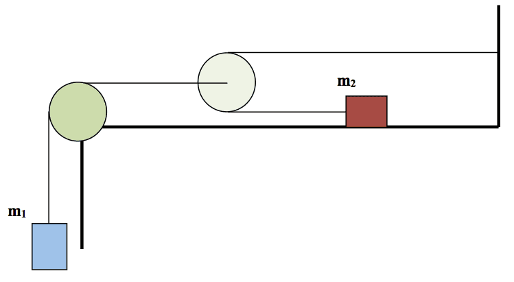

In the system shown, the strings and the pulleys are ideal. There is no friction anywhere in the system. As the system is released, block m1 moves downward.
If the magnitude of the acceleration of block m1 is a, what is the magnitude of the acceleration of block m2?
If mass m1 moves down by x, the pulley attached to m2 moves towards left by 2x, Hence block moves by 2x. Hence, acceleration of block 2 is 2a. Am I right?
I have a problem with constraint equations. If someone could clear it, please.

No. Think of it this way : if mass m1 moves down by distance x, then all the points on the string attached to it move by distance x. Which means the center of the horizontal pulley also moves to the left by x, not 2x, since after all it is fixed to the string.
Ya, I realized. How do I relate the acceleration of the two blocks?
When you displace the horizontal pulley by a distance x to the left, how much excess string would you need for m2 to remain stationary?
Also, the string it needs to move the distance x, is compensated by block 2 moving to the left by a distance x. Because the other side of the string that run through the pulley is attached to the wall. Therefore, block going down by x, would move the pulley to the left by x. Differentiating twice would give a1 = a2. But that's no the right answer.

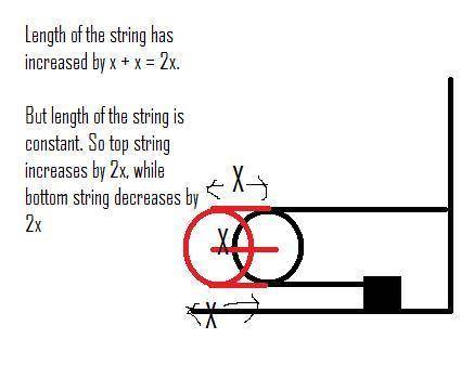

Nope. Think of it this way : the top of the pulley moves by a distance x, but the bottom also moves by a distance x. That means both the top portion of the string, and the bottom portion have increased by x, which can't happen as the length of the string is fixed. So the mass moves by 2x to the left.
Basically, your answer is correct, but the method by which you reached it was not.
Still haven't got it. You mean a1 = 2a2 is correct? Yup, it is. But I got it by manipulation. Haven't understood the problem. I always had a problem with constraints. By the very basics of it.
If both the top and bottom strings have moved by x, shouldn't it be x1 = x2?
Can the total length of the string(s) change?

In case it's not clear, dreamLord is pointing out that although your answer below is right, the statement above is wrong. To see this, ignore m2 and the string attached to it, and think of the top pulley as just a block. What you may have had in mind is that the top pulley both moves (by x) and rotates.
In this drawing, the figure in red is when the pulley has moved by distance x to the left. Does this help?

Okay, Thanks! Got it. Haruspex is right. I was considering the pulley to be rotating.

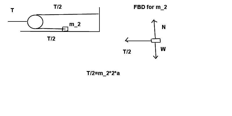

Also, what would be the tension in the string attached to block 2? Would it be T? I know the tension on the string running from pulley to block 1 is T, because the tension is same in the string throughout. But what about the tension in the string attached to block 2?
Would it be T11 = 2T2? therefore tension on string attached to block 2 would be T1/2. Correct?
What are the forces on the horizontal pulley? Can there be a net force on the pulley if its massless? Use that to find the relationship between the two tensions.
Horizontal force on the pulley would be T11 = 2T2, so block 2 would be T11/2 = T2
I think you mean ##F_p = T_1 - 2T_2##. And yes if you then use the fact that ##F_p = 0## you will get what you originally stated (I just wanted to make sure you knew why the result followed).
Yep, that relation is correct for the tensions.

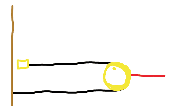

Basically, could I crudely imagine it like this, with the situation drawn upside down (see attachment)? If so, why do we necessarily need the pulley to rotate (as in attachment)? Why couldn't the pulley simply glide forward and have the string roll over its surface without the pulley having to rotate in order to make it roll? Thanks.
