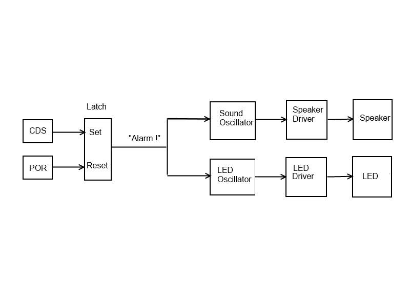

I have to construct a circuit for my Physics class. The circuit must be tripped by a CDS Cell (Detects changes in light) and, once being 'tripped' it must play a continuous sound and make an LED flash on and off.
This picture is of the circuit board we are allowed to use, and of the 'Burglar alarm' found in the instruction book. The alarm is connected to terminals here, and is tripped by one of the wires being pulled out. I already re-configured it to be connected to the CDS cell, and now when I pass my hand in front of the CDS cell it activates the speaker.
However once I move my hand from the CDS cell range, the sound stops. I need it to continuosly loop until the circuit is turned off. I also need a flashing L.E.D attached.

You will probably need only one of the JK flip-flops, not both. The CdS detector will control an input to one JK flip-flop, and a output of that flip-flop will control your buzzer. Do a google search if you are unsure how a JK flip-flop works. (BTW, it is unlikely to use a 555 IC.)
A description of a flip-flop's operation won't include the verb "loop".
What NascentOxygen said.
Think through the problem. I believe you have two not one.
The first is not really a problem with the sound generator, it's a problem with the signal from the CDS. The problem is that the signal from the CDS is transitory (when you remove your hand it goes away). What you need to do is use the CDS signal to SET a latch. The latch can then be used to control both the sound and the LED.
So you could arrange for the latch to be SET by CDS and RESET by a power cycle. You could use one of the JK latches or you could build a simple SR Latch from two nand gates...
http://commons.wikimedia.org/wiki/File:Sr-latch.png
Google "Power on Reset" for a simple way to do that. Typically an RC circuit is used.
The second problem is flashing the LED. Presumably you want this to flash at a relatively slow rate not at the sound frequency? So you may need to build another oscillator that runs at the LED flashing rate also controlled by the output of the latch.
I shouldn't design the circuit for you but here is a block diagram of how I would approach it. Some blocks you already have...
