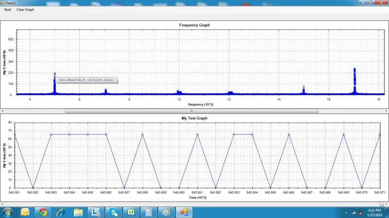

I am trying to make this
but my FFT is not getting close enough to the right Values
I am Sampling at a 44100 Hz rate
and I am sending
16384 samples to the fft at a time
but it is not close
I have attach a pic
what should i do?
I know the FFT work.. because i compared it to mat lab...
so how can I troubleshoot this?

I have posting on my other fft threads... but I just enter sinewaves and just buffer with samples, both in mat lab and in my program.
if you look at my picture you will see that
youtube is outputting a frequency of 117Hz
but my programs highest peek is over 60 then 70.
that is not right
no I am not windowing my sample before the FFT...
the FFT gets raw data

ok i can't add the right picture on here... the forum will not let me ...
but this is how it looks
the highest peek is 2500
which is haft of 5000

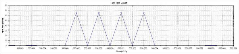

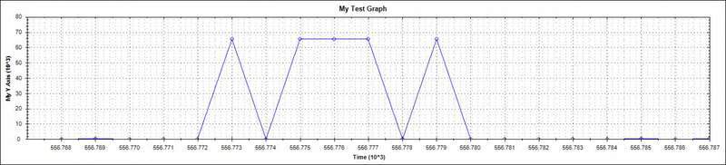

this is how the sample input looks
it repeats

I think the problem is that the audio data is signed 16 bit integers (between -32768 and +32767) but your code is converting them to unsigned integers between 0 and 65535.
Try this:
Code:
            int tempint = 0;
            for (int index = 0; index < 32768; index += 2)
                buffer1[tempint] = ((buffer[index + 1] << 8) |
                                        buffer[index + 0]);
                if (buffer1[tempint] > 32767)
                    buffer1[tempint] = buffer1[tempint] - 65536;
                tempint++;
If would be better just to declare buffer as an array of 16-bit signed ints instead of unsigned 8-bit bytes, then you can just copy the data from buffer to your double array buffer1.
ok you where right about between -32768 and +32767
the ftt is a lot less noisy...
and the print out of the samples look a lot better ...
however, I am still getting half the Frequencies...
I can just do * by 2 at the very end and get the right Frequencies but I really want to know why it is doing this
