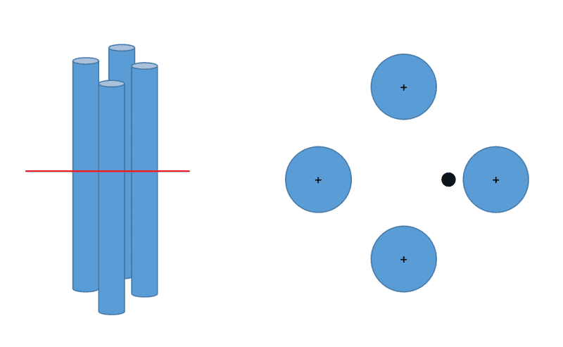

Hi,
I have four cylinder with circular cross section. Each has the same potential (+V) applied to it. They are all the same size, length, diameter etc. and each are spaced an equal distance apart so that they all touch on to an imaginary circle with a distance x from the origin.
How to calculate the E field in between these cylinders?

just incase i am not on the same page as u. this is what i was thinking of in the attahed png image. the black dot is the positive test charge. left is 3d view, right is a 2d cross section somewher along the middle of the cylinders
tks
  • Left: 3D view of four parallel blue cylinders with a red horizontal line cutting across them. Right: 2D cross section of four blue circles at the corners of a square, with a black dot to the right of the centre.

I interpreted post #1 as touching cylinders. If they do not touch, there will be some electric field. Yes, this field will be a bit stronger close to the cylinders, and a positive charge would be repelled by positively charged cylinders.

No, with such a setup you have an electric field.
A two-dimensional numerical simulation will work. Make a fine grid, solve for the potential at every point with the Poisson equation, then calculate the electric field as the derivative.

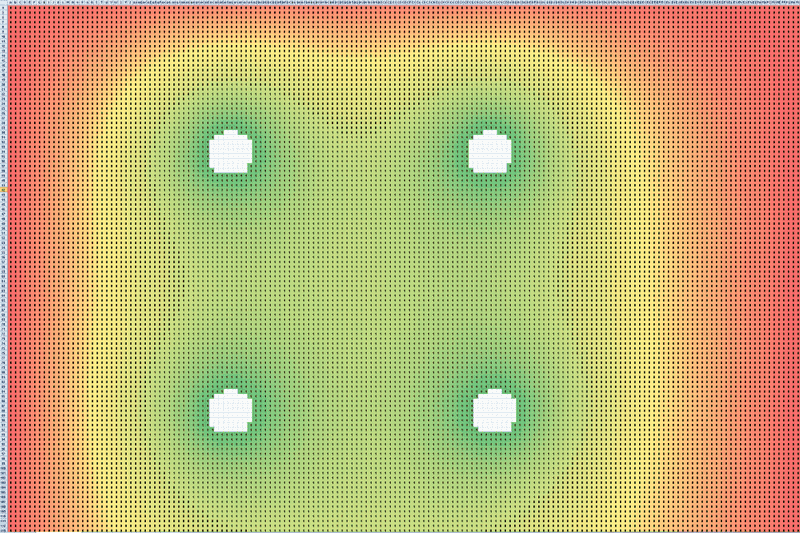

For cartesian coordinates with a rectangular grid, the Poisson equation simplifies to "every cell has a potential that is the average of the 4 cells around it". Fix the potential of cells that are in your cylinders, fix the potential "far away" (borders of the simulation, far away from the cylinders), iterate the calculation of averages until the system does not change any more.
Edit: quick and dirty with excel:
Heatmap of a potential field on a rectangular grid, red at the edges fading to yellow and green toward the centre, with four white square blocks near the corners of the field.

very nice how do u do it. how long did it take to calculate? i never thought of using excel.

what is far away and to what potential do u fix it?
is it possible that u can share the excel formula with the corresponding theory. that wud be helpful to see how u did it.

As described. I fixed some cells (in four roughly circular patterns) to 1 and the boundary to 0, then I let each cell to be the mean of the four surrounding cells and let excel solve it iteratively.

Every finite distance will introduce some error, but you cannot calculate infinite grids of course. Something that is far away compared to the size of the cylinder structure will keep the error small.
I attached the file. I changed the central potential values to 9 so the 1-digit display has a bit more details than "1" and "0", Everything changes linearly, so the absolute values are quite meaningless anyway.

how do u manage to change the cewll colors to follow the magnitude in excel? its nice.
how would u then use the information provided from the grid to determine how a test charge might behave moving in the field between the cylinders. cud that be done in excel also?

I don't know how it is called in English, but probably something like "conditional formatting". There are options for spectra like that.
Excel is not a good tool for precise results, but it is quick to set up something there.
