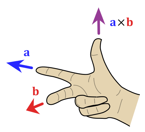

Reading the PF "cross product page" i get ixj=ijsin90=ij
I also found that "The cross product of two vectors A and B is a third vector (strictly, a pseudovector or axial vector) perpendicular to both of the original vectors, with magnitude equal to the product of their magnitudes times the (positive) sine of the angle between them, and in the direction determined by the right-hand rule."
This leaves me more confused about what my xy and xz's are??
So the cross product is a vector. To specify it, you need to specify its magnitude and direction. First the magnitude. What is the product of the magnitude of i times the magnitude of j times sin90o? Don't forget that i and j are unit vectors.
Now for the direction. What does the right hand rule say about it?
again trying to remember 11c, a unit vector is just a vector of length 1unit? so the magnitude of ixj must be 1?
I could be applying the rhr to the wrong section of this problem but for Fy the direction i get the force to be is to the right and for Fz the force is straight down(using conventional planes)
I am using http://hyperphysics.phy-astr.gsu.edu/hbase/magnetic/magfor.html just replacing i with q. Just to try and let you know how I am thinking I used the values that were in the question(could have worked out direction without doing any calculations?).
Yes and yes. Now for the direction. It must be perpendicular to the xy plane, but there are two perpendiculars. By definition the +z direction (unit vector k) is in the ixj direction. So the cross product between two unit vectors is another unit vector in a direction perpendicular to the two (or zero). Back to my first post. Find the following cross products
