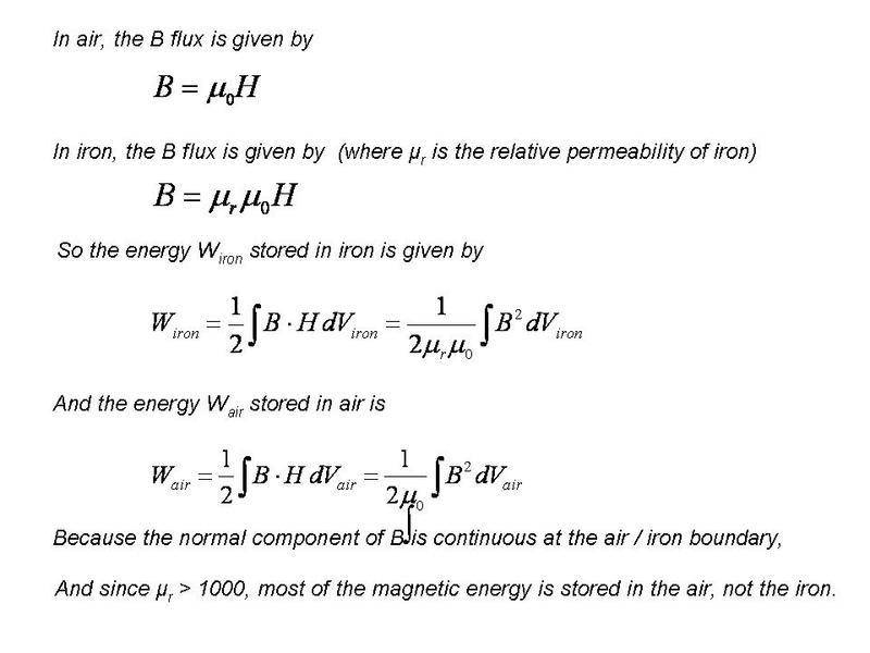

Err... no. Very little energy is stored in the iron. Because the normal component of B is continuous, the energy density is higher in the air than in the iron. See thumbnail.
Bob S

The basic form for the energy stored in a magnetic field is
W = (1/2)∫ B H dV
In a magnetic system that has both iron and air in the same flux, only B (the normal component) is continuous at the air / iron interface. So we write
W = (1/2μrμ0)∫ B2 dV in iron, and
W = (1/2μ0)∫ B2 dV in air
