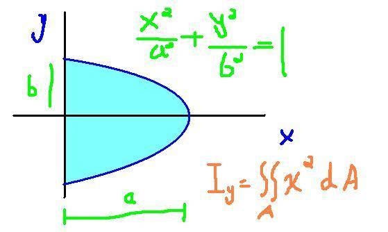

Determine by direct integration the moment of inertia about the y-axis in the figure shown.
See Iy on attached.
Equation for curve also on attached.
My answer didn't include pi, and the answer apparently does. I'm trying to do this via a double integral as opposed to using one integral and doing something funky. My problem I THINK is in finding dA.

You are right. There is no "[itex]\pi[/itex]" in the solution.
The moment of inertia of that figure, about the y-axis is
[tex]\int_{x=0}^a\int_{y= -b\sqrt{1-\frac{x^2}{a^2}}}^{b\sqrt{1-\frac{x^2}{a^2}}} y dydx[/tex]
That's easy to integrate and has no "[itex]\pi[/itex]".
Hmm - that's what I thought. In fact, I think that's the exact integral that I had. I'll give it another go. Thanks!
I lied - that's a y^2, not just a y in the integral. The answer is pi*a*(b^3)/8...Still no luck though.
