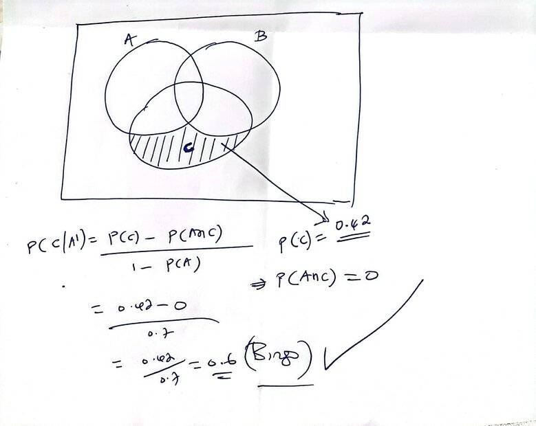

@scottdave wawawawawawa this was a nice one man! Phew. Seen it...
  • Handwritten Venn diagram of three overlapping circles labeled A, B and C inside a rectangle, with region C shaded; beneath it, the derivation P(C|A') = (P(C) - P(A and C)) / (1 - P(A)), giving 0.62 - 0 over 0.7 = 0.6, marked Bingo with a checkmark.
