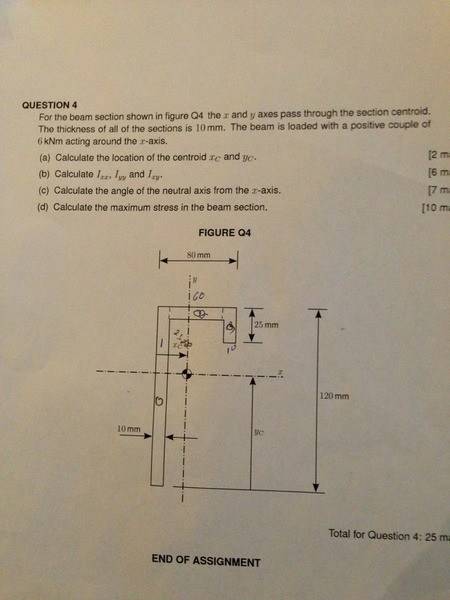

Calculate the angle of the neutral axis from the x-axis when the beam is loaded with a positive couple of 6kNm acting around the X-axis

Ya got any pictures of this problem?
This is the the question
