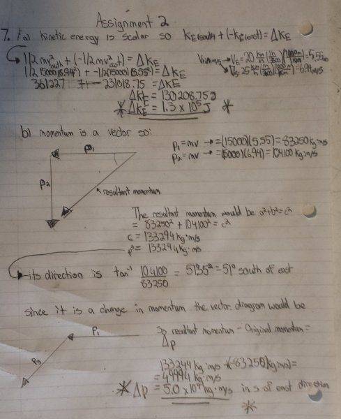

Hi, I think I have got the right answer for the question but I was really hoping someone could verify it for me. My work is shown on the attachment. Final answer = 5.0 * 10^4 kg*m/s 51 degrees south of east direction. ( I forgot to add the 51 degrees on the attachment final answer)
Thanks a bunch :)
Hello BW.
For part a:. It's not meaningful to work in seven digits after first rounding off to three (for v). What you do at the end (bring back to 2 digits) is fine. because the first digit is a 1, you might consider giving one digit more (matter of taste/habit).
For part b. you might draw a wind rose to begin with. Most folks would have East pointing to the right.
Now go back to what Simon says: just like with the kinetic energy scalars, you want the difference. What you draw is the sum of the two momenta.
Instead, p1 + change in p = p2 , so ##\ \ ## change in p = p2 ##-## p1 .
So draw p1 starting at the origin. Draw p2 starting at the origin. The vector "change in p" is from the tip of p1 to the tip of p2 ! If you want to see that starting at the origin, you have to add up p2 and ##-##p1. Post the drawing: to get your head around this the right way is an important learning step.
Another tip: the m and the 1/3.6 are common factors. Much easier to work with symbols and do all the calculation work with the 20 and 25 , then apply these factors at the end.

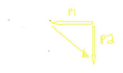

Hi BvU
Thanks for the reply. I am still a little confused about the change in P though. I re-did my vector diagram. Both vectors start at the origin. But from here I am confused. Is the change in vectors the hypotenuse, from what I understand by Simon this is true but you state "p1 + change in p = p2 , so change in p = p2 − p1" which makes more sense to me because I don't know how the change in momentum would be larger than p1 or p2. If I do it this way I get a change in momentum of 2.1 * 10^4 kg *m/s in the 51 degrees south of east direction. I'm just not sure what the hypotenuse has to with at all anymore though. your help is greatly appreciated

p2-p1 is your hypotenuse vector.
To see this, say the two vectors you drew are from point O. To represent -p1 you need your p1 pointing the other way. To then add this to p2, i.e. p2+(-p1), you need to start the -p1 vector at arrow end of the p2 vector. So you will have p2 pointing 'down' from O to P, say, then -p1 pointing from P to the right, reaching point Q.
The resultant, p2-p1 is then the vector from O to Q. This looks exactly like the hypotenuse you have drawn, but shifted over to start at O.

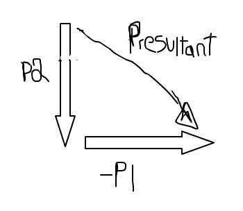

Hi haruspex
Thanks for the reply. Ok so the vector looks like this. I'm not sure why though -p1 is facing east though because I thought its initial vector was in the east direction. Don't we turn around a vector when subtracting? sorry to keep asking but I feel as though I am missing something.

Sorry, I based my post on your diagram and did not check back with the original question. So flip left/right in you diagram in post #5 and in my reply in post #6.

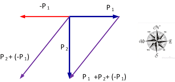

In a picture what I described in #4
And I persist in using "to the right" as East (Couldn't find a windrose agreeing with your picture o0) )
What happened to Haru is a nice demonstration of the importance of a clarifying sketch !
As you see:
| the change | is bigger than either |p1| or |p2| .
(but it doesn't have to be: if p2 = p1 then |thechange| is 0
and if p2 = -p1 then |thechange| is 2|p1|
That's the wole thing about vector addition/subtraction )
