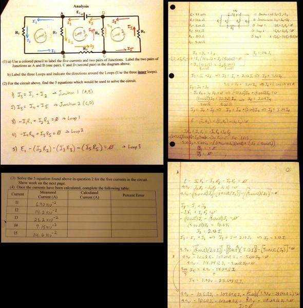

The question involves Kirchoff's Rule.
I'm having a hard time trying to calculate the currents in the given circuit.
I'm trying to solve question number 3 in the attached image (the image on the bottom left hand corner). I have already measured the currents in lab, but I'm having trouble doing the calculation part.
I'd appreciate the help, thanks.

Are you comfortable solving a matrix?
Try setting up the equations in matrix form and solving.
It's been some time since I've done matrix. Is it an easier way to figure out the five currents? I'd be glad to learn this different approach to solving the problem.
That's always the method I use for solving so I would say yes, it's definitely an easier way to solve this type of problem. Using the equations given I would set it up as follows:
<br /> \left[ {\begin{array}{cc}<br /> 1 &amp; 1 &amp; -1 &amp; 0 &amp; 0 \\<br /> 0 &amp; 0 &amp; -1 &amp; 1 &amp; 1 \\<br /> -R_{1} &amp; R_{2} &amp; 0 &amp; 0 &amp; 0 \\<br /> 0 &amp; 0 &amp; 0 &amp; -R_{4} &amp; R_{5} \\<br /> 0 &amp; R_{2} &amp; R_{3} &amp; 0 &amp; R_{4} \\<br /> \end{array} } \right]<br /> \left[ {\begin{array}{cc}<br /> I_{1}\\<br /> I_{2}\\<br /> I_{3}\\<br /> I_{4}\\<br /> I_{5}\\<br /> \end{array} } \right]<br /> =<br /> \left[ {\begin{array}{cc}<br /> 0\\<br /> 0\\<br /> 0\\<br /> 0\\<br /> E_{1}\\<br /> \end{array} } \right]<br />
Do you see where this comes from when using your equations? Do you remember how to row-reduce?
I'm trying to understand, but can't seem to figure how you placed them in matrix. No, don''t remember how to reduce.
I'll look over matrices online, I'm seeing the pattern. I appreciate the help CLever-Name, thank you.
Using matrices is a difficult concept to grasp at first but it's an extremely useful tool once you understand, for that reason I am going to try and explain it here.

I think it would be easier at this point to substitute in numbers in our matrix. The values I can read from your pictures produce the following (correct me if I'm wrong):
<br /> \left[ {\begin{array}{cc}<br /> 1 &amp; 1 &amp; -1 &amp; 0 &amp; 0 \\<br /> 0 &amp; 0 &amp; -1 &amp; 1 &amp; 1 \\<br /> -10.6 &amp; 5.00 &amp; 0 &amp; 0 &amp; 0 \\<br /> 0 &amp; 0 &amp; 0 &amp; -10.2 &amp; 5.00 \\<br /> 0 &amp; 5.00 &amp; 34.5 &amp; 0 &amp; 5.00 \\<br /> \end{array} } \right]<br /> \left[ {\begin{array}{cc}<br /> I_{1}\\<br /> I_{2}\\<br /> I_{3}\\<br /> I_{4}\\<br /> I_{5}\\<br /> \end{array} } \right]<br /> =<br /> \left[ {\begin{array}{cc}<br /> 0\\<br /> 0\\<br /> 0\\<br /> 0\\<br /> 9.9\\<br /> \end{array} } \right]<br />
You said you have worked with matrices in the past so I am going to stop here. Hopefully it has refreshed your memory on how to row-reduce. If not then I can continue on and give you a little more guidance as to how to procede
On the I5 row of last matrix posted the 10.2 should be a 5.00 = R5.
So after reducing, I can solve for all five currents?

And those currents don't look right. Plug you values back into the first equation
I_{1} + I_{2} = I_{3}
It doesn't add up.
Are you able to show your steps? Maybe I can find where you went wrong.

The first way you wrote it isn't correct, but you corrected it in the second post so that's good.
With a system set up this way you need to perform some operations on the matrix first before you can evaluate for your missing quantities. I'll show you some of the steps for this situation:
<br /> \left[ {\begin{array}{ccccc|c}<br /> 1 &amp; 1 &amp; -1 &amp; 0 &amp; 0 &amp; 0 \\<br /> 0 &amp; 0 &amp; -1 &amp; 1 &amp; 1 &amp; 0 \\<br /> -10.6 &amp; 5.00 &amp; 0 &amp; 0 &amp; 0 &amp; 0 \\<br /> 0 &amp; 0 &amp; 0 &amp; -10.2 &amp; 5.00 &amp; 0 \\<br /> 0 &amp; 5.00 &amp; 34.5 &amp; 0 &amp; 5.00 &amp; 9.9 \\<br /> \end{array} } \right]<br />
Here I have set it up as an augmented matrix. So we have [A|b] in the above matrix, this is easier to work with but you need to recognize that the vertical line indicates Ax = b and not just A = b.
Continuing on we want to reorganize it so that we can easily row-reduce. So first I want to do the following:
Shift the 3rd row to the 2nd, the 5th row to the 3rd, the 2nd row to the 4th, and the 4th row to the 5th. Giving us:

Shouldn't the 37.8974 on the third row be 32.8974?
After this then the -1 on the fourth row needs to be eliminated then the -10.2 on the fifth row.
Nevermind, sorry another mistake. Figured how you did the elimination in row three:
(34.5+5.00) - (5.00/15.6)*5.00 = 37.8974
So, that means in the next row:
R4 + (1/37.897)R3 -> R4
(1+1)+(1/37.897)(34.5) = 2.910
R4=2.910
And the last row -10.2 needs to be eliminated.
R5 + (10.2/2.910)R4 -> R5
R5 = 50.952
Is this correct? Learning how to post the matrices in code, don't know how to hide the left, right text from code.

Almost, but not quite.
Our operation on Row 4 is R_{4} + \frac{1}{37.897}R{3} \rightarrow R_{4}
Giving us:
<br /> \left[ {\begin{array}{ccccc|c}<br /> 1 &amp; 1 &amp; -1 &amp; 0 &amp; 0 &amp; 0 \\<br /> 0 &amp; 15.60 &amp; -10.6 &amp; 0 &amp; 0 &amp; 0 \\ <br /> 0 &amp; 0 &amp; 37.897 &amp; 0 &amp; 5.00 &amp; 9.9 \\<br /> 0 &amp; 0 &amp; 0 &amp; 1 &amp; 1.132 &amp; 0.261 \\<br /> 0 &amp; 0 &amp; 0 &amp; -10.2 &amp; 5.00 &amp; 0 \\<br /> \end{array} } \right]<br />
Explicitly we have to assign the operation to EACH column of Row 4 and 3.
Thus we have 0 + 0 for the first column. 0 + 0 for the 2nd column. -1 + (1/37.897)(37.897) = 0 for the 3rd column. 1 + 0 = 1 for the 4th column. 1 + (1/37.897)(5) = 1.132 for the 5th column. And this operation also has to be applied to the outside column as well. Giving us 0 + (1/37.897)(9.9) = 0.261 outside.
Thanks for the help and the patience Clever-Name, appreciate the step by step procedure as to how to solve this problem using matrices. Seems a lot a work than I thought it would be, but I actually like this approach, just need to practice more. Thanks.
It does seem pretty daunting at first but once you get the hang of it it really is a nice method. We might as well go the next 2 steps to complete our solution. From my last matrix we do the following step: R_{5} + 10.2R_{4} \rightarrow R_{5}

If we were to now write this again in it's full (Ax = b) form we would have:
<br /> \left[ {\begin{array}{cc}<br /> 1 &amp; 1 &amp; -1 &amp; 0 &amp; 0 \\<br /> 0 &amp; 15.60 &amp; -10.6 &amp; 0 &amp; 0 \\ <br /> 0 &amp; 0 &amp; 37.897 &amp; 0 &amp; 5.00 \\<br /> 0 &amp; 0 &amp; 0 &amp; 1 &amp; 1.132 \\<br /> 0 &amp; 0 &amp; 0 &amp; 0 &amp; 16.546 \\<br /> \end{array} } \right]<br /> \left[ {\begin{array}{cc}<br /> I_{1}\\<br /> I_{2}\\<br /> I_{3}\\<br /> I_{4}\\<br /> I_{5}\\<br /> \end{array} } \right]<br /> =<br /> \left[ {\begin{array}{cc}<br /> 0\\<br /> 0\\<br /> 9.9\\<br /> 0.261\\<br /> 2.662\\<br /> \end{array} } \right]<br />
This is equivalent to the same setup we had at the very beginning. We can now expand this out to give us some linear equations and we end up with:
I_{1} + I_{2} - I_{3} = 0
15.60I_{2} - 10.6I_{3} = 0
37.897I_{3} + 5I_{5} = 9.9
I_{4} + 1.132I_{5} = 0.261
16.546I_{5} = 2.662
Now you can easily work from the bottom up and solve for I_5, then I_4, etc. etc. Getting all of your currents out of it.
