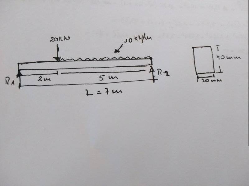

1. Homework Statement :
E=220GN/m²
L= 7m
W= 20kN at 2m from the left edge.
udl=10kN/m from x=2 to x=7
Beam supported in x=0 and x=7
width= 20mm
height=40mm

I don't match your moment equation. The shear force is constant at 32.14 out to x = 2. Then, the part at x > 2 kicks in.
