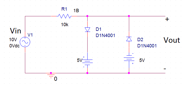

Calculate the Vout vs Vin characteristics for input voltages of 5V to 10V peak.[/B]
Would Vout simply be nothing because the diodes are connected in anti-parallel?

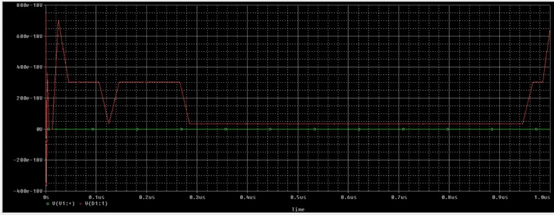

Putting a volt probe at Vin and Vout gives something like: (Green is Vin, red is Vout)
Why is Vin not shown as a sine wave?

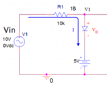

Now let's extend our view of the circuit slightly to include the power source and resistor:
If the diode forward voltage remains essentially constant so long as the diode is conducting (a pretty good approximation for this situation), what do you expect to happen to V1 for different values of Vin?

V1 would be 0 if Vin is 5V to 5.6V, but the same as Vin if Vin is higher than 5.7V
mveep said:
V1 would be 0 if Vin is 5V to 5.6V,...
Make that 5.7 V rather than 5.6 V. You said the forward voltage of the diode is 0.7 V.
mveep said:
...but the same as Vin if Vin is higher than 5.7V
How? Which one of the two voltages in the diode branch can change while the diode is conducting? Will the 5 V source change value? Will the 0.7 V diode forward voltage change?

Ok, so V1 = 0 for Vin less than 5.7V
No, if the diode is not conducting what's the current through the resistor?
The 0.7 forward voltage will change
No. It cannot. The forward voltage of a diode is (almost) constant.
If the diode isn't conducting, there would be no current through the resistor correct?
Correct. So what is the potential drop across it?
If there's no current, there's no potential drop right?
Correct again :smile:
So what does that make V1 (so long as the diode is not conducting)?
So V1 would be Vin?
mveep said:
So V1 would be Vin?
Yes! So V1 "follows" Vin until the diode conducts. Then it is held at 5 V + VD no matter how high Vin goes. That is, this branch limits the maximum voltage of V1 to 5.7 V.
Do a similar analysis for the other diode branch alone.

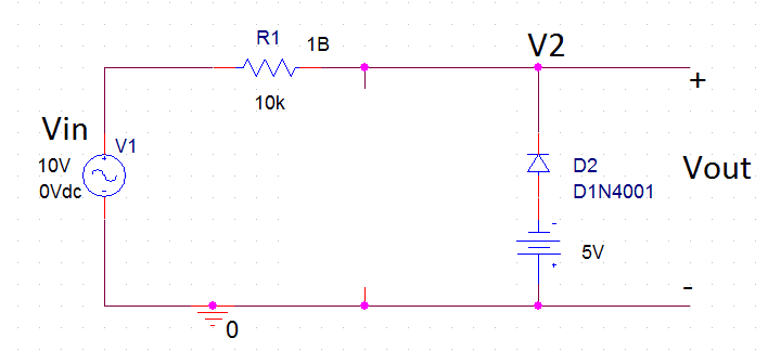

The voltage at V2 would always be Vin because the diode is in reverse saturation?
I don't think that "reverse saturation" is a valid term. Perhaps you mean cuttoff (not conducting)? That would be true if Vin could only take on positive values. What happens as Vin goes negative?
reverse bias and reverse saturation were the terms I learned in class
When Vin goes negative, it will add with the +5 source?
You can think of it that way if you're doing KVL around the loop. You should be able to find the conditions for Vin where the diode is cut off and when it is conducting, just as for the other branch.

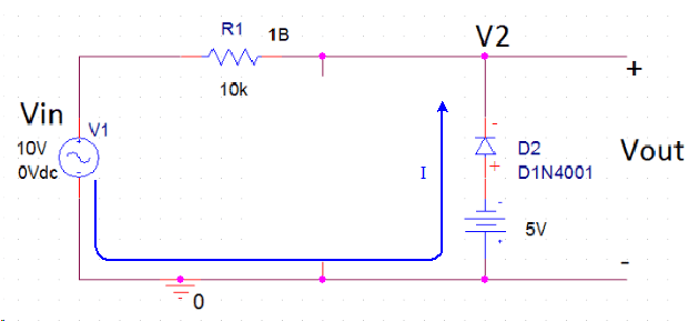

No. Think about it, the two circuits are essentially the same (Vin, 5 V, resistor, diode), the only difference being the diode branch is inverted. So the two should behave symmetrically.
With the diode reversed, it's forward voltage drop's direction is reversed in the branch, too. So it still "adds" to the 5 V (it's potential drop has the same direction as that of the 5 V source). Note the potential drop for the diode in the image below:
So this too (V2) would be Vin until -5.7V, and then capped at -5.7V?
Right.

What would Vout look like? Do you happen to have any idea why my PSpice generated graph is showing 0V for Vin?
That would depend on what Vin looks like and how much of Vin lies between the +/- 5.7 V clipping limits of the circuit.
Nope. Often that sort of issue is due to forgetting a connection or making an incorrect parameter setting. The scales on the graph in your first post look suspicious, being on the order of 10-180.
