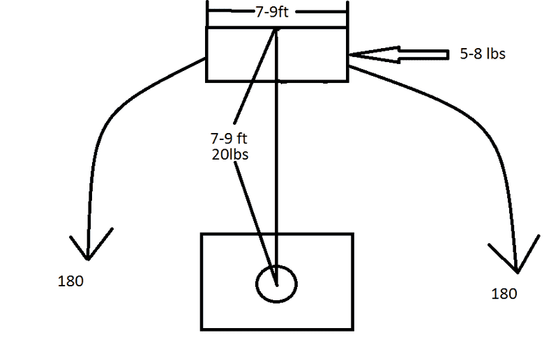

I'm trying to figure out what type of motor I need to use that has the ability to lift a 7'-9' pole that has about 5-8 pound weight attached to it at the end. The max angle that the poll will be is 180 degrees and the motor will need to lift it to 90 degrees. As for the weight its not a free swinging weight its attached. The poll will need to be lifted from the bottom end.
:welcome:
A picture or a sketch will help us to visualize what you are talking about. Use the Upload button.
Anorlunda,
Thank you for the reply, hopefully this diagram helps.
Thank you
So you have a pole up to 9 feet in length which masses 20 pounds. On the end of this pole is a mass of up to 8 pounds. You wish to be able to rotate this pole in a controlled fashion up from horizontal to vertical or down from vertical to horizontal. No speed requirements are given.
Since there is no speed requirement, any size motor will do. You just need to gear it down sufficiently to provide the requisite torque.

This much I know. I just need to know what is the minimum amount of torque that is required to perform such a feat . Once I know the torque, I can than get a decent motor and apply the appropriate, gears ration, pulley ratio and or worm gear to complete this task. I just don't know the formula to calculate the torque I need.

From ordinary experience, it should be clear that the required torque is at its maximum when the pole is horizontal. However, there is a simple approach that can address that concern: A counter-weight. Or springs.
If we are going to determine how much torque you need, we need to know what sort of counter-weight you are able to provision. And how variable the load will be.
Edit:
That said, the formula for torque is easy -- force multiplied by perpendicular distance. If the pole is nine feet long, weighs twenty pounds (force) and is extended horizontally, that's 4.5 feet * 20 pounds = 90 pound-feet of torque about the endpoint. Add to this an eight pound (force) weight nine feet out, that's another 9 feet * 8 pounds = 72 pound-feet of torque about the same endpoint. Total 162 pound-feet.
Minus whatever you can arrange to cancel with suitable counterweights, springs and such.
If no counterweight is possible...
The torque required to just hold it horizontal it would be..
(20*4.5) + (8*9) = 162 ft.lbs
In practice you need more torque than that to move it but how much depends on how fast you want to move it.

Just wondering as to why the 20 pounds gets multiplied by half the the size of the pole.
The center of mass of the pole is at 4.5 feet from the axis of rotation. The total weight of the pole can be considered as if it acted at that point.

First, to size a motor, you must define how much power you need. Let's do a simplified analysis.
The power is defined by the torque times the angular velocity. The maximum torque needed will be when the pole is horizontal at 162 lb.ft or 220 N.m. It will decrease at it goes up. The average speed is 1 deg/s or 0.0175 rad/s. Therefore, assuming you've reach the average speed instantly, the maximum power would be:
$$220\ N.m \times 0.0175\ rad/s = 3.85 W$$
So you need a motor than can produce about 4 W. But is it reasonable to assume that the average speed would be reached almost instantaneously?
Let's assume we want to reach the average speed within 1 deg of rotation or 0.0175 rad. So the constant acceleration needed is (as @CWatters showed how):
$$\frac{(0.0175\ rad/s)^2}{2 \times 0.0175\ rad}= 0.00875\ rad/s^2$$
With the corrected mass moment of inertia (1/3 instead of 1/12) as calculated by @CWatters, i.e. 48.6 kg.m², you can find the extra torque needed to accelerate the pole to its average speed within 1 deg of rotation:
$$48.6\ kg.m^2 \times 0.00875\ rad/s^2 = 0.43\ N.m$$
Which is a ridiculous amount compared to the 220 N.m that your motor is already producing to hold the pole. So it is OK to assume that you will reach your average speed almost instantaneously with such a motor.
