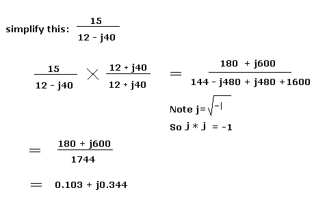

You may be able to follow this example:
It starts off with a complex number 12 - j40 in the bottom line. See what happens when you multiply by 12 + j40 / 12 + J40. The J's vanish and you get something you can deal with.
Thank you. This should help me.
