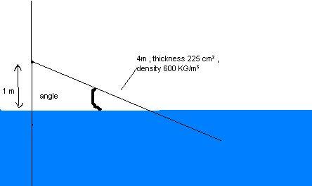

1. Homework Statement
a wooden stick , length 4 meters , density = 600 kg/m³ and thickness = 225 cm² is attached on a hinge 1 meter above water
so the point is u got to find the angle the stick makes with the horizontal water
you will see the drawing in the jpg file
3. attempt
none , don't know where to begin
but i tried to set up an equitation of this system , i don't know how to involve the hydromechanical part in it
your attachment is pending, so i ll give you a general hint.
the stick floats at an angle to the water surface, assume the angle as theta, you know the center of mass of the stick, find the center of bouyancy(its midway of the submerged part of the stick, you know the height of water(i am assuming this) you have assumed the angle, find the submerged length, simple trigo). take the moments about the point of contact of the stick with the container(reaction passes through that point, so it won't have any moment). solve

if theta is the angle to the vertical, cos (theta) = water height/length of submerged part of stick
actually its the angle to the horizontal :)

is this basic idea right :
momentum of the non under water part = momentum underwater part
G pulls the non underwater part downwards and Archimedes pushes the underwater part upwards ?
so the weigth of the non underwater part multiplicate with the length of the non underwater part = archimedes force multiplicate the length of the non under water part
damn hydraulics
some part right but a large part wrong
you are confusing bw moment and momentum, they are different. here moment is considered
moment of the whole stick weight(weight acting at CoM, gravitational force) = moment of buoyant underwater part(buoyant force acting at midway of underwater part, archimedes force)
but u have to incalculate the moment of the tension force also , becos the stick is attached on an axis
and i guess ill need more equitations for this problem ...
geez i don't know what tension you are talking about. if you are talkin about the forces developed in the stick itself, don't worry boy, those forces pass through the hinge point, so no moment coz of them
