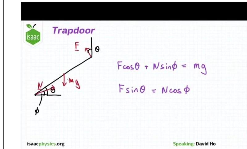

Find the value of tan φ to 2 sf where φ is angle made by line of action of reaction force at hinge above horizontal.
https://isaacphysics.org/questions/trapdoor_num
Part B Angle of reaction force
  • Mass of uniform trapdoor: m=4.0kgm=4.0kg
  • The trapdoor is held open making an angle θ=60∘θ=60∘ to the horizontal.
Information assumed
- Magnitude of the gravitational field strength, g=9.81ms−2
[/B]Don't know how to move on with this simultaneous equation
Fcosθ + Nsinθ=mg
Fsinθ = Ncosθ
ephphatha16 said:
Fcosθ + Nsinθ=mg
Fsinθ = Ncosθ
Shouldn't some of those angles be φ?
You will also need to consider torque balance.
Yeah true
Fcos θ + Nsin φ = mg
F sin θ = N cos φ
But I don't know what values to plug in ... is the first equation about vertical component and the second equation about horizontal component?
φ will not depend on m or g. You are given a value for θ.
Yes, but you have three unknowns, F/mg, N/mg and φ. You need a torque balance equation.
