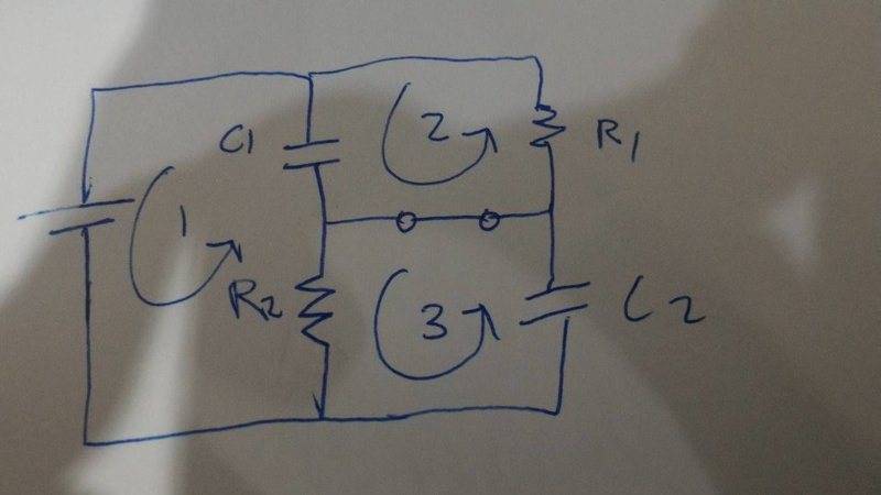

An electric circuit is shown as above.
The switch S is closed for a long time and the current flowing is constant.
Given that C1 = 3 μF, C2 = 6 μF, R1 = 4 kΩ, R2 = 7 kΩ
If the power at R2 resistor is 2,4 W
a) Determine the charge at C1
b) When the switch is opened, after some miliseconds, how much does charge at C2 change?
KVL, KCL
I still have no idea whether the current at right loop is zero when the switch is opened. Please help..

You probably don't want to apply mesh analysis until you've first determined where current can flow. At steady state, capacitors behave like open circuits (no current flowing through them). If you take your circuit diagram and erase the capacitors, that's how the circuit looks at steady state as far as the available current paths are concerned. You can apply whatever analysis method you wish then.

At mesh 1, it will be counter-clockwise since if it's clockwise, the current can't get to the resistor (it will meet the dead-end a.k.a steady state capacitor first).
I think the circuit will just be like voltage - R1 - R2..

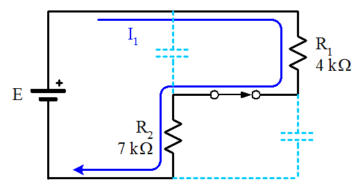

A good attempt. Although the direction of your mesh current won't matter, you just have to identify the mesh first. In fact, with the capacitors eliminated from consideration there is only one loop. If you re-draw the circuit assuming that the capacitors are open circuits:

Re-draw the circuit without the switch. Consider the phrase "some milliseconds" to be equivalent to "after a long time". Given that you now know the source voltage, what voltage will end up on C2?

Can you determine the value of the source voltage from what you now know from part (a)?
Draw the circuit without the switch branch (it's open so it can be removed from consideration). What potential difference is across the C2 branch?

No. You're looking for the potential across the capacitor after a long time. What's the steady state current through a capacitor?

There is a slightly different voltage divider equation for capacitors. Since every capacitor in series has the same charge, and since the voltage on a capacitor depends on its charge, smaller capacitors end up with larger voltages and larger capacitors end up with smaller voltages. Thus for two capacitors in series the voltages are inversely proportional to their capacitance. If you have two capacitors C1 and C2 in series and a total voltage V across them, then:
##V_{C1} = V \frac{C2}{C1 + C2}##
##V_{C2} = V \frac{C1}{C1 + C2}##
gneill said:
Current flows until the potential across the capacitor equals the potential across the voltage source and the potential drop across the resistor is zero. When the potentials are the same there is no potential difference to drive current through the resistor.
For a series connection the same amount charge flows onto both (since they are in series they must share identical current). If the capacitors have different values then they end up with different potentials across them (Q = CV).
Thanks a lot. You're the best!
