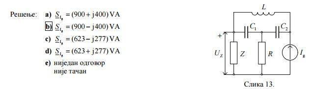

In sinusoidal circuit shown in Figure 13 is known : w =10^6 1/s, R = 100 Ohm ,
L = 300μH , C1 = 10nF and C2= 5nF . Reactive power of coil inductance L is QL = 3kVAr ,
RMS value of the voltage receiver impedance Z is UZ = 100 V , and the voltage UZ phase delaying behind
electricity generator Ig for pi / 2. Calculate the complex apparent power S of that generator.

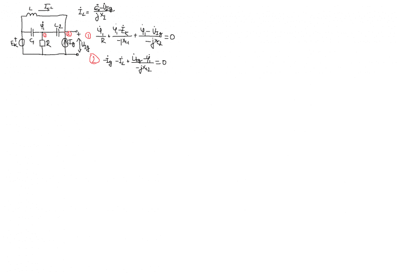

I set current source at angle 0. Ig = Ig exp( j*0) = Ig
By compensation theorem , I replaced impendance Z with ideal voltage source Ek =Uz exp(-j*pi/2) = -j100 V
From QL = IL^2 * XL , I get IL = sqrt(QL/wL) = sqrt(10) A.
Using node voltage method
I get result from the picture.
The problem is that there are too many unknowns (2 equations and 3 unknowns) , well I got RMS value of IL but I still don't know it's angle.
I am pretty stuck at this point.

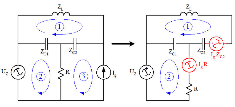

If I may make a suggestion? Try mesh analysis. The loop with the current source ##I_g## is already "solved" since the mesh current will equal ##I_g##. So remove the loop (remove ##I_g##) and replace it with a suitable voltage source in each branch that that loop current passes through. Solve for the loop current through L. It will be in complex form. That will take of your missing angle for the current through the inductor.
Left: circuit with source U_Z, inductor Z_L on top, capacitors Z_C1 and Z_C2, resistor R, and current source I_g, with three mesh loops numbered 1, 2 and 3. Right: the same circuit after replacing the current source with voltage sources I_g R and I_g Z_C2, shown in red.

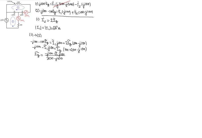

Mesh analysis I got
Uz-Ig = I2*(ZC1 + R) - I1 *ZC1
Ig*ZC2 = -I1(ZL+ZC+ZC1)+I2*ZC2
and IL=I1=(UZ-ZC2*Ig)/ZL
After solving these equations I get that Ig = -j
and IL = UZL (-90) / ZL ( 90) => gives angle of -180 degrees therefore I got IL = -sqrt(10) in complex form
But as you can see from the picture I get really big I2 I am doing something wrong .
And UIg = Ig*ZC2 + I1 * ZC2 + Ig*R + I2 *R ?

In your first mesh equation on the left had side Ig should be multiplied by R. I'm not seeing how you arrived at your equation for IL.
Note that since Ig provides the phase angle reference, it should end up being a purely real value.
Why don't you drop in the actual impedance values for the components? The mesh equations should simplify quite a bit that way.
Circuit schematic with two mesh loops labelled 1 and 2: a 3 kVAr element with j300 impedance at top, capacitors -j100 and -j200, a -j100 source at left, a j200 Ig dependent source, a 100 Ig dependent source and a 100 ohm resistor.
(Note that the polarity of the source in loop (1) has been reversed rather than write its value as -j200 Ig)
But I still don't know the current I1 ,and therefore I can't calculate Ig.I know that | I1 | = | IL | = sqrt(10) , but that seems kinda useless when those are complex equations.
Handwritten circuit analysis: a small schematic with two mesh loops labelled 1 and 2 and a 100 ohm resistor, followed by mesh equations (1) and (2) in complex phasors, the substitution I2 = 2Ig, and the expression for Ig in terms of I1.

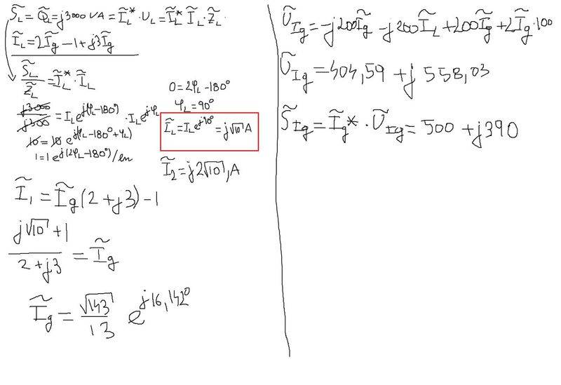

Taking your equation (2) and dividing though by -100:
##I_g + j = -j I_1 + (j - 1) I_2~~~~~~~~~~~##..(2')
Substitute (1) into (2'), solve for ##I_1##:
##I_g + j = -j I_1 + 2(j - 1) I_g##
##I_1 = -j(-3 I_g + 2j I_g - j)##
##I_1 = 2 I_g - 1 + j 3 I_g~~~~~~~~~~~~~##..(3)
That's a bit easier to work with.

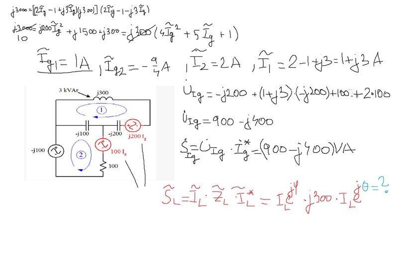

The complex power associated with the inductor will be j3000 (units: VA). It will be given by the inductor voltage (##I_L Z_L##) multiplied by the complex conjugate of the inductor current. The inductor current is identical to ##I_1##. See if you can find ##I_g## by that route.
Okay it should be (EXPRESSION for current complex current IL) , IL * exp(j*fi) * IL * exp(-j*fi) ... not angle (180 - fi) , but that 's gives zero exp(j*fi -j*fi) , and I get sqrt(10) * 1 * sqrt(10) * 1 ---> IL = 10 and that doesn't make any sense .
##j 3000 = (I_1 Z_L)(I_1^*)##
So inserting (3) from post #6:
##j 3000 = \left[ (2 I_g - 1 + j 3 I_g)(j 300) \right] (2 I_g - 1 - j 3 I_g)##
Solve for ##I_g##. There should be two candidate values.
Thank you I got the right answer now
Handwritten circuit analysis with a circuit schematic showing a 3 kVAr label, inductor j300, capacitors -j100 and -j200, a 100 ohm resistor, dependent sources 100 I_x and j200 I_g, and mesh loops 1 and 2. Beside it are handwritten equations for U_Ig and S_Ig = (900 - j400) VA, and a power equation S_L = I_L Z_L I_L* in red.
image sharing
By the way what angle should I put for theta at red equation.
And by what theorem did you replace current source Ig with Ig*ZC2 and Ig*ZC1 ?

For a complex conjugate you just negate the angle. That is, ##\left( I e^{j θ} \right)^* = I e^{-j θ}##
I'm not aware of any particular named theorem that prompts what I did to distribute the ##I_g## current supply as voltage sources. But it certainly obeys KVL and mesh analysis rules. If you left the current source loop in place and wrote the mesh equations for loops (1) and (2) you would be able to pick out the terms that correspond to the mesh current ##I_g## passing through the common branch impedances. These are the potential changes imposed by ##I_g## flowing through those impedances. Since ##I_g## is a given current quantity they correspond to voltage sources. So I suppose this is a version of the "compensation theorem" that you invoked in your first post..
