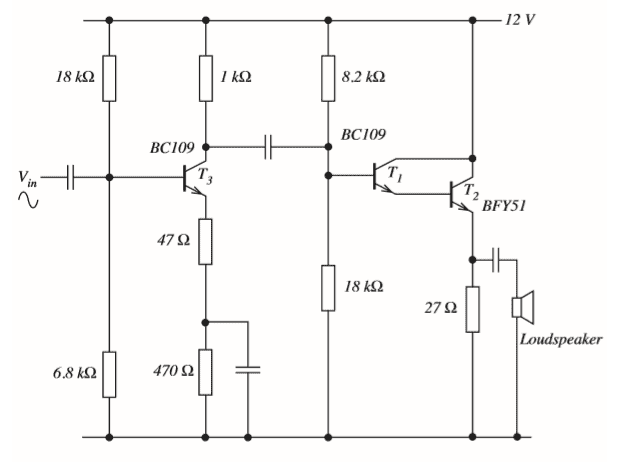

Hi all.
I need a bit help with the following.
Estimate the power developed in the 8 Ω speaker of the circuit of FIGURE 2 for a 1 kHz sinusoidal input signal of 100 mV peak. All capacitors may be assumed to act as a short circuit at the frequency of operation.
Compare your estimate with that derived from a PSpice simulation.
(I uploaded a picture of the circuit)
Gv common emitter= Rc/Re , Gv emitter follower ~1 , power developed (Vrms^2)/R
The gain of the first stage(common emitter):
as the 47 ohm resistor is not bypassed the gain becomes 0.1x1000/47=2.127V
As the question is only wants an estimate the second stage (emitter folower) can be estimated to have a gain of 1. So the peak voltage in the speaker is ~2.127V
to get the power developped I need the rms voltage which is 1.5V
and the power is 1.5^2 /8 =0.281= 281mW
But when I look at the PSpice simulation it differs:
the voltage by the output of the first stage is ~1.5V and the voltage in the speaker is a peak ~1.4
and the power developed in it is 245mW peak and 150mW rms
Can you help me where am I wrong?
Thank you!

I agree with this approach, but be careful not to call 0.1x1000/47 the "gain" of the first stage. The "gain" of the first stage is -1000/47, and you have multiplied by the peak input voltage to get the peak output voltage. Your calculation is okay, I would just call it the calculation of the peak output voltage of the first stage. The "-" sign is not important in this problem, so maybe that's why you omitted it.
As for the simulation, since PSPICE does not have "ideal" capacitors as elements, what values did you use for the capacitors? I'm guessing that's why you are getting a lower gain out of the simulation. Can you check the gain through the first stage to see if it's -1000/47 as expected?

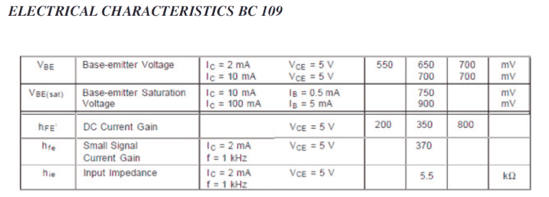

Thanks for your answer. I remembered that I forget to add re to the equation which is hie/hfe.
(a data sheet was given to this assessment).
For this transistor hie=5.5kohm and hfe=370
so re= 5500/370=14.86
The gain of the circuit is then 1000/(47+14.86)=16.16
So the output signal of the first stage is
0.1x16.16=1.619V
Using the same assumption as before for the emitter follower stage gain ~1

I know what you mean by that, but the data sheet I was given to the assignment doesn't contain the value oh hoe, nor the hie of the BFY51 transistor (the second one, hie2), so I am unable to calculate the load on the first stage as the hie of the combine transistors is hfe1 x hie2. For the same reason I cannot calculate the exact gain of the emitter follower.
As the assignment only asks for an estimate I assumed that hoe is very large and can be ignored (used this assumption through the module) and also that the emitter follower stage has unity gain

1) At first, a general remark:
In electronics, no formula is correct by 100% because we always neglect some minor influences. Hence, each expression is an approximation which - more or less - for a specific application can be regarded as sufficiently exact. That means: Applying a formula, we must be sure that the "surrounding conditions" allow the usage of the formula.
2) Your circuit: For the common emitter stage you have used the expression G=-Rc/Re .
What will happen for Re=0? G approaching infinity ? No - of course not!
Are you aware that this rough approximation may be used only under the condition Re>>1/gm ?
Here is the "exact" gain expression: G=-Rc/[(1/gm)+Re].
I think, in your case, the inverse transconductance 1/gm=Vt/Ic must not be neglected against Re=47 ohm.
Hence, as a first step it is necessary to find the DC quiescent current Ic.
This will be one reason for the discreapency between your calculation and Simulation.
Remark: Of course, during calculaton you have to consider the fact that the first stage is loaded by the second stage (the input resistance of the 2nd stage is in parallel to Rc)
Sorry I put the wrong formula in the equations box
I used Gv=-Rc/(Re+re)
Where re is hie/hfe in this case
5500/370
Is that sounding better?
5500/370
Where are these values coming from? Do you know the DC operating point (Ic) ?
There is a data sheet given to the assignment that's where I got hie and hfe
But hie strongly depends on the actual DC operating point...
My calculation: Ic~5.5mA re=Vt/Ic~4.7 ohms
Gain of the first stage (second stage connected): G=850/(47+4.7) ~ 16.4
(Simulation 16.3)

How did you calculate the input impedance of the second stage?
The only equation I know to get it is
Rb||(hie+Roc(1+hfe))
Where Rb=8.2k||18k and Roc=27||8
But hie is not given for the second transistor and the equation to calculate it is not in the module?!? Also what is Vt in your calculation?

The calculation of the actual DC current Ic for the first stage is based on two unknown (and only estimated) parameters (Vbe=0.7 V and beta=Ic/Ib).
Therefore, it makes no sense (and is good engineering practice) not to be as exact as possible for the second stage.
Hence, I have used only the resistive voltage divider (18k||8k) for the 2nd stage input resistance.
I think, for an emitter follower this is a sufficient approach.

In the learning materials supplied I can only find ones stating that gain is simply Gv=-Rc/Re ?
Gv=-Rc/Re is a simplification of Gv=-Rc/(Re+re) and is generally 'Close Enough' for Emitter currents above 10-20mA and there is an Emitter resistor is in the circuit.
For instance, using the simplification, what is the gain if there is not an Emitter resistor?
re varies with Emitter current, and for Silicon transistors re≅40/IEmA,
for Germanium transistors re≅26/IEmA.
Cheers,
Tom
Cheers,
Tom
Hi Tom, thanks for the reply.
I see that makes sense that it is just further approximation.
Out of interest without: -21.27659574 and with -16.16426387. Seems like quite a large difference?
I realize the discussion above but just wanted to gain some clarity on the full methodology:
So if I have gain as -16.164 then I can use this to find the voltage from the first stage e.g. 16.164*0.1=1.6164V​
Assuming second stage emitter follower has a gain of 1​
Peak voltage in the speaker in 1.6164V and RMS of 1.1430V​
So peak and RMS powers are V2/R for both so 326mW peak power and 163mW RMS power.​
This seems quite far off from the estimation found by @Merlin3189 below.
Is this due to the approximation nature of the formulas or have i tripped up somewhere in trying to interpret this thread?
Merlin3189 said:
250 mW
That's what I think of as estimating.
I'm amazed to find that PSpice gave 281 mW, only 12.4% higher.
Hmm... I think we used different Emitter currents in the 1st stage; yours may be a bit more accurate. I used the Base bias network without accounting for the Base current. That could account for 12% difference in re.
I did a quick-'n-dirty calc and came up with either 207mW or 283mW:
1st stage:
IE = 5.0mA
re = 8
Gain = 18.2
Vout = 1.82V peak, 1.29V rms
Pout @ 8Ω = 207mW
re = 0
Gain = 21.3
Vout = 2.13V peak, 1.5V rms
Pout @ 8Ω = 283mW
Accounting for Base bias current:
IE = 4.45mA
re = 9
Gain = 17.9
Vout = 1.79 peak, 1.26V rms
Pout @ 8Ω = 199mW
Close enough for me!
That's why we use simulators like LTSpice to account for all the variations. Much easier.
If you really want to track down any diffrences, please show ALL you calculations.
Cheers,
Tom
1st stage:
IE = 5.0mA
re = 8
Gain = 18.2
Pout @ 8Ω = 207mW
re = 0
Gain = 21.3
Pout @ 8Ω = 283mW
IE = 4.45mA
re = 9
Gain = 17.9
Pout @ 8Ω = 199mW
Cheers,
Tom
Hi Tom, Thanks for the reply!
Sorry how did you get the first stage IE without ß as you would be unable to use Ib = (Vcc-Vbe)/(Rb-(ß+1)Re) ?
The calculation I completed is as follows:
I used Av (voltage gain) so used Av=-Rc/(Re+re') where re' = Hie/Hfe
so that would be Av=-1000/(47+(5500/370) = -16.16426387
And as before:
I then have a gain of -16.164 then I can use this to find the voltage from the first stage e.g. 16.164*0.1=1.6164V
This is far more inaccurate than your calculation, would be interested in how you went about it.
Thanks Tom!
Jason
As I said, "quick-'n-dirty."
I used an hfe of 100, whereas the datasheet shows between 125 and 900. I calculated the Base voltage divider, then the Emitter voltage, the Emitter current (4.45mA), divided by 100 (hfe) to find Base current which was about 10% of the divider current; at that point I figured 10% was "Close Enough" for a quick calculation and proceeded.
The major difference is instead of using re = (5500/370) = 14.9Ω,
I used re = 40/Ie = 40/4.45 = 9Ω
Gain = 1000/(47+14.9) ≅ 16.16 (your values 14.9Ω = re = (5500/370) )
Gain = 1000/(47+9) ≅ 17.86 (my values 9Ω = re = 40/Ie = 40/4.45)
Please note:
hie is the small signal, AC, Base Input Resistance at a specified Collector current, and it is inversly related to Collector current. Its value can vary by a factor of 9 over the operating range. See figure 13 at: https://www.onsemi.com/pdf/datasheet/2n3903-d.pdf
As such, calculating signal resistance from dividing Resistance by current Gain is problematic. Especially when the Collector current differs from the datasheet value!
Cheers,
Tom

Ah I see, I find it strange that you managed to assume hfe of 100 and reach a closer answer than mine when I used the values given with the question (below), not sure how my value is further off than yours?
So after finding the gain of the first stage (16.16 in mine and 17.86 for yours) how do you then get to a gain of 21.3 to then achieve the 283mW for the second stage? I assumed an emitter follower could just be considered to have a gain of 1?
I didn't go back and read the whole thread, I used a datasheet I found on-line for the BC109 transistor, which had slightly different values (probably a different manufacturer since the page formats were different).
If you look at post #26, you will see there are three separate calculations, with successivly finer detail. You are mixing numbers from different calcs.
The first solution of 283mW had a 'first order approximation' ignoring both Base bias loading and re.
The last solution of 199 mW included both Base bias loading and re.
If you want further confusion see post #5, there are other things still left out.
And for some caveats see post #11.
I think this has been beaten to death at this point.
I hope the discussions/conclusions have helped with a better understanding of the pitfalls of circuit design. For instance if this was a design for production the tolerance of all the components must be considered, to insure that most of the assemblies would meet the minimum requirements. If you are experimenting at home you can either decide you are 'close enough' or change some values to get closer. :oldwink:
Have Fun!
Cheers,
Tom
